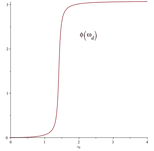

One question I have is about writing the following
$$\tan{\beta}=\frac{\gamma\omega_d}{\omega_0^2-\omega_d^2}\tag{18}$$
If you try to plot this with Maple, you will get a result that isn't correct for the problem. It seems we lose information in going from (17) to (18).
What justifies writing (18) instead of (17)? If I recall correctly, I see (18) much more frequently than (17) in textbooks/notes/etc.

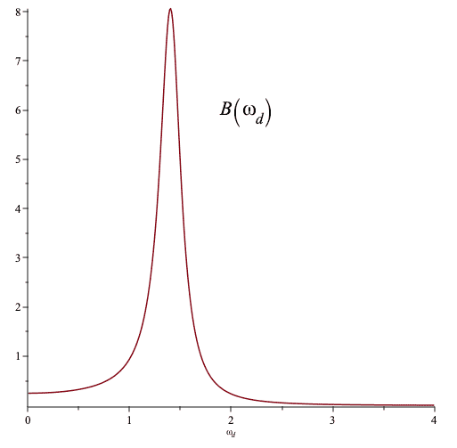

The amplitude of the steady-state solution is
$$B=\frac{A_0}{(\omega_0^2-\omega_d^2)^2-\gamma^2\omega_d^2}=\frac{1}{(2-\omega_d^2)^2+\frac{\omega_d^2}{16}}$$
A plot of this function is

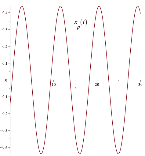

My question is about the consideration of the initial conditions.
Suppose
$$\omega_d=\frac{\omega_0}{2}$$
Then, the steady-state solution is
$$x_p(t)=\frac{32}{73}\sin{(0.7t-0.34)}$$
The amplitude is ##32/73## and the phase lag is ##-0.34\text{rad}##.
I am interested in what is happening at ##t=0## here.
What is the meaning of the negative value of ##x_p(0)## here?
I guess that for the initial conditions implicit above, the homogeneous solution is just zero. But what does this mean exactly?

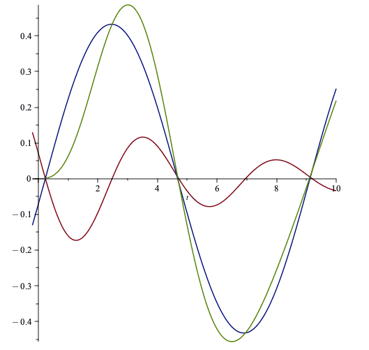

Here are the calculations to obtain the general solution
$$x_g(t)=x_h(t)+x_p(t)=e^{-\frac{\gamma t}{2}}A\cos{(\omega t-\phi)}+\frac{A_0}{(\omega_0^2-\omega_d^2)^2+\gamma^2\omega-d^2}\sin{(\omega_d t-\beta)}$$
The two unknowns here are ##A## and ##\phi##, ie the amplitude and phase of the homogeneous oscillations.
Imposing ##x(0)=0## and ##\dot{x}(0)=0## we obtain
$$\tan{\phi}=\frac{\frac{\gamma}{2}d_1-d_2}{\omega d_1}$$
$$A=\frac{d_1}{\cos{\phi}}$$
where
$$d_1=\frac{A_0}{(\omega_0^2-\omega_d^2)^2+\gamma^2\omega-d^2}\sin{\beta}$$
$$d_2=\frac{A_0\omega_d}{(\omega_0^2-\omega_d^2)^2+\gamma^2\omega-d^2}\cos{\beta}$$
For the numerical example in the OP, a plot of ##x_h##, ##x_p##, and ##x_g## is
The green curve is the solution. It is composed of the blue particular solution and the red homogeneous solution.
We see that the homogeneous equation is chosen to make the initial conditions true.
What exactly are you plotting? If it involves arctan, that introduces an ambiguity. ##\tan(\alpha)=\tan(\alpha+\pi)##.
Exactly, it introduces ambiguity.
The expression ##arg(...)## does not have this ambiguity. This is why I am now using this expression.
Ok, but you can also fix it by adding pi if the denominator in ##\arctan(\frac yx)## is negative. (I think that works.)
zenterix said:
is there more than one possible particular solution?
If p(t) is a particular solution and h(t) is the homogeneous solution then ##p+\lambda h## is the general solution if we consider ##\lambda## to be a free variable, but if we fix a value of it, ##\lambda_0##, then ##p+\lambda_0 h## represents another particular solution, no?
That's true. We have infinite particular solutions because we can add any homogeneous solution to any particular solution.
I don't know the specifics, but in terms of vector spaces, it seems the homogeneous solutions are a vector space and the set of particular solutions are not a vector space, but rather an affine subset.
The initial value problem in the OP has a unique solution. So even though we may start with a particular solution that is different from the one shown in the OP, it is different by a specific homogeneous solution. When we add a general homogeneous solution and determine the two unknown parameters to give the initial conditions, I imagine that the sum of this new homogeneous solution with the one added to the the particular solution will always give the same result which is the one I derived in the second post.

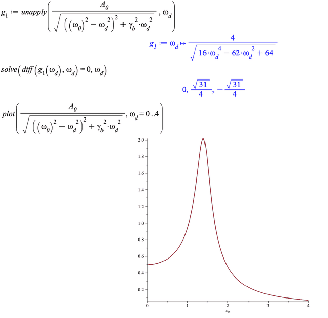

For the record, I revisited this problem today to check some calculations. In the OP I plotted ##B(\omega_d)## but that plot was incorrect. I forgot a square root in the expression for ##B(\omega_d)##.
Luckily, the shape of the plot remains the same and the maximum has the same algebraic expression when we use the correct form with the square root in the denominator.
Just in case someone is confused in the future about that part of the OP, here are the correct calculations.
For the numerical example given, we have for the amplitude as a function of driving angular frequency
For a general problem, we have
