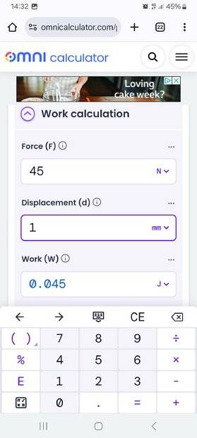

I broke it down to 1 mm distances. Over 66 mm at which point the feild strength was insignificant. I then performed a work calculation per 1 mm to gain the joules, I got the feild strength from a online field strength calculator. I then added up the joules from each 1mm and it came to 0.3673 j per magnet. I then found out the 2 magnets working together is no a simple doubling but rather the percentage increase changes over distance so I used an average of plus 70%. So the answer to my question is approximately 0.62441 J.

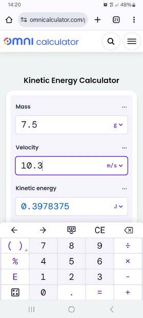

And have a velocity of approximately 10 m/s2 taking approximately 0.66 seconds to complete the movement.

If you are posting these numbers expecting confirmation that they are correct, you need to provide more detailed information.
1. You say you used an online field strength calculator. Where did you find it? More importantly what was the input to the calculator and how did you use its output to find work per 1 mm?
2. You say "I then found out the 2 magnets working together is no a simple doubling but rather the percentage increase changes over distance so I used an average of plus 70%." What on Earth is that all about? What, specifically did you find out that made you draw this conclusion? It seems that you are calculating the work done on each magnet and then claim that adding the two works (a simple doubling) is not the same as "the two magnets working together". How did you do this second calculation? Energy is conserved, so if your additional calculation says that 30% of the 2×0.62441 Joules is lost you must explain where it went.
3. How did you find the numbers for velocity and time? What assumptions did you make? Also, m/s2 is not the appropriate units for velocity which are m/s. If you meant m/s2, these are units of acceleration. So which did you calculate, velocity or acceleration?

On line feild calculator https://www.kjmagnetics.com/calculator.repel.asp?calcType=block
Online physics calculator https://www.omnicalculator.com/physics/kinetic-energy ... yes you're correct m/s not m/s2 my mistake. See attached for velocity calculation.
I've tried to find the physics website that told me about the percentage with reference the moving magnet but I can't find it, I closed the tab after. But the feild strength will double but the actual force acting on the moving magnet varies with distance and configuration therefore it not a doubling of force acting on the moving magnet.
Was I knew the velocity because I had the work I could the determine the amount of time it would take to travel the given distance.
