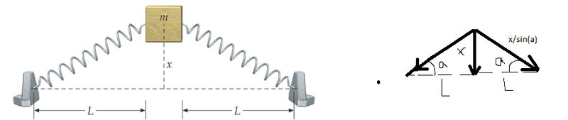

Hi

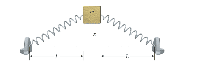

I want to calculate the potential energy of the following figure in function of x
Here is my attempt :
mgx + 1/2*k*(sqrt(x^2+L^2)-L)=1/2*m*v^2
Is that correct ?
thanks
I really suck at physics, but I think that the forces exerted by the two springs should cancel each other out. So, the only thing which comes into play is gravitational potential energy. Someone please correct me if I'm wrong.
Edit: I think have taken only the mass m into account.

Welcome to the PF.
Not quite right. Please do not deleted the Homework Help Template that you are provided when starting a schoolwork thread here. It helps to organize your thoughts, especially showing the Relevant Equations.
Your "equation" does not make sense in the context of the question you posed. The potential energy does not depend on velocity (why is that on the righthand side of the equation?)
Can you list the Relevant Equations for this problem? If you want to find the PE(x), you will add the gravitational PE to the PE of the stretching springs. Please draw a FBD of the mass in the middle, showing all of the forces on it.

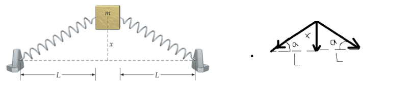

here is my draw :
Is it correct?
thanks
Closer :smile:
You have the gravitational PE correct at mgx.
The PE from the stretched springs has to do with the force in the vertical direction, not in the directions of the springs. Take the vertical component of the spring force(s) to get the PE contribution from the stretched springs.

mgx = 1/2*k*(x/sin(a) - L)^2 + 1/2*k*(x/sin(a) - L)^2
Is it correct?
thanks
Is it correct?
thanks
Closer still, but you should be adding mgx to those spring terms. You want an equation for PE(x) = ____________________
I'm also not real clear why you are dividing by the sine of the angle a...

PE(x) = mgx -1/2*k*(x/sin(a) - L)^2 - 1/2*k*(x/sin(a) - L)^2
(x/sin(a) - L) means that the distance of the stretched spring ... So x/sin(a) is total new distance and L is old distance .. So the difference x/sin(a)-L is the distance of the stretched spring ..
thanks
Ah, I get the distance thing now with the x/sin(a)-L. But that just gives you the PE from the force of the spring in the direction of the spring, not in the vertical direction. The horizontal forces of the two springs on the mass cancel out.

No, energy is a scalar. The PE in the springs relates to their extensions. It does not have components.

Do you have any idea how to build the equation of the potential energy for the system

Nearly right, but in my experience stretching a spring increases its potential energy.

I can, but you are going to. The equation you wrote would have the springs' contribution to the total PE decreasing when the springs are stretched. What do you think must be wrong?

is it the signs ?
PE(x) = mgx +1/2*k*(x/sin(a) - L)^2 + 1/2*k*(x/sin(a) - L)^2
ramialsaiad said:
is it the signs ?
Yes.

It strikes me that from that figure, the block may be moving on a horizontal surface.

Is that the force of the block in function of x is : F(x) = k*(x/sin(a) - L) + k*(x/sin(a) - L)
and the kinetic energy in function of x is : KE(x)= 1/2*m*v^2 + 1/2*m*v^2 (I cannot express it in x)
Is that correct ?

Why the two 1\2 mv2 terms?
You probably need to express it in terms of dx/dt.

We have two springs so the kinetic energy should be double as much ,, is not that?

From what I know we use f = kd only if the springs are mass-less... So you they don't actually have kinetic energy.
What you should substitute there is the mass of the object not the springs

The kinetic energy is possessed by the mass m, and there is only one of those. The springs are considered massless. The mass does not care how it gets its KE, whether from one spring or two.

No, that's your job.
To recap:
In post #16 you had the right expression for the potential energy in the springs.
Unless you have some good reason to suppose it is in the vertical plane, go with Sammy's suggestion that is is horizontal, so discard any gravitational term.
In post #21 your force equation is quite wrong. You cannot add forces acting in different directions as though they are scalars. If you want the net force from the springs then you need to consider the x and y components of the forces. (This is the path berkeman was going down, but he wrongly tried to apply that to the PE of the springs instead of to their tensions.). But I don't think you need to worry about forces anyway, just concentrate on energy.
In post #21, your KE expression had two copies of 1/2 mv2. There is one mass m moving at speed v, not two.
From all that, see if you can put together the correct expression for the total energy.
