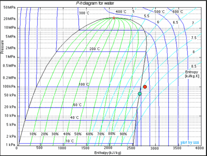

If you compress water vapor isothermally, it will, of course, eventually condense. However, if you compress water vapor adiabatically, it will not condense because the increase in temperature resulting from doing work on the vapor will be too large, and move you away from the saturation envelope rather than toward the saturation envelope. The figure below illustrates this for our problem.
P-h diagram for water with pressure in MPa and kPa on the vertical axis and enthalpy in kJ/kg on the horizontal axis, showing saturation dome, isotherms, entropy lines, and two marked points.
This is a thermodynamic diagram for water. The green dot on the figure shows the conditions at the inlet to our compressor at 0.5 bar and 81.3 C. Note that this dot lies on the saturation curve for the vapor. The red dot shows the conditions at the oulet of the compressor at 1 bar and ~ 146 C. This dot lies outside the saturation envelope for water, squarely in the superheated region. Note the lines of constant entropy on the diagram. For this adiabatic reversible compression (isentropic), both the red dot and the green dot lie on the same constant entropy line s = 7.594 kJ/kgK.
Our analysis using the ideal gas law gives virtually the same results as those using the steam tables or the thermodynamic diagram. This in itself speaks for the validity of using the ideal gas law for the vapor.

Thank you for this detailed answer. But, still the question is how it can be calculated that the temperature of steam will be at 146C. The graph you have given is the pressure-enthalpy chart of steam and I again want to know how to calculate the final temperature.
I provided the entire analysis for this in post #10, using both the Enthalpy Method and the Ideal Gas Method. The pressure-enthalpy chart shows constant temperature lines, and you can see that the final condition (red dot) lies about half way between the 100 C line and the 200 C line. The key to getting the final temperature is to treat the compression as being adiabatic and reversible.
The graph is clear, but I just want to know how you have calculated that the final temperature is 160C.
The final temperature is not 160 C. It is 146 C. At the exit pressure of 1 Bar, you need to determine the temperature that gives you the same entropy as that at the inlet. So getting the final temperature using the Enthalpy Method involves interpolating in the steam tables:
