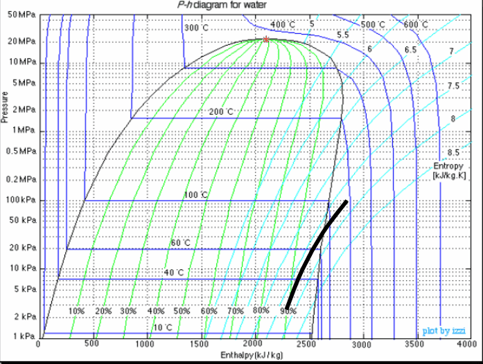

To be precise, I want to know what will happen if both steam and water are compressed together adiabatically. In such case, the steam will always be in touch with water and therefore can't be superheated and have to remain saturated. In such case, what should be the power consumption?

Just pick a mass percentage of liquid water in the container to begin with. I will then solve the following problem for you, if that is OK:
Insulated Container
Liquid water and water vapor initially in container at equilibrium at 20 C
Adiabatic reversible compression of the contents (no heat exchange with atmosphere outside container).
Calculate change in internal energy, work, and changes in amounts of liquid water and water vapor.
Would you prefer that I solve this, or would you prefer to do the calculation.

OK, but I still need you to specify an initial mass fraction for the liquid water. The pressure vs volume relationship for the contents of the container is going to depend on the initial mass fraction of the liquid water. And this determines the work required per unit mass of cylinder contents.

You'll see that when we work the problem. Please, just be patient. I am suggesting that we assume 10 mass percent liquid water and 90 mass percent water vapor initially at 20 C. Is that OK with you?

Okay. I think we are ready to begin. Do you want to go first or shall I?
Incidentally, in this closed adiabatic system, the work will be equal to the change in internal energy, not the change in enthalpy.

I have obtained a rough estimate of the solution to this problem using the Graphical Method on a pressure enthalpy diagram:
The thick black line in the figure shows the series of states that the cylinder contents passes through as they are compressed. We start off at the lower left end of the line with a saturated mixture of liquid water and water vapor at 20 C and 0.0234 bar, featuring 90 % water vapor and 10% liquid water. As the contents are compressed, the temperature and pressure rise in tandum (according to the saturation vapor pressure relationship) and the liquid water gradually evaporates while the amount of water vapor increases. The total entropy of the contents of the container does not change, because the process is adiabatic and reversible. To satisfy this condition, the amount of liquid water has to be decreasing, while the amount of water vapor has to be increasing. When the contents reaches about 70 C and 0.30 bar, all the liquid will have been evaporated and we will have 100% saturated water vapor in the container. If we compress the contents of the container further than that, the vapor will enter the superheated region. If the contents were compressed to 1 bar, the superheated vapor will be at a temperature close to 200 C.
I will fine tune these results using the data in the steam tables, if your are interested.

This is not correct. When you compress a vapor adiabatically, its temperature increases. This increase in temperature of the vapor can cause the liquid to be heated. Heating the liquid can cause its temperature to rise and can also cause some of it to evaporate.
In the calculations that we are talking about, we are assuming that the combination of liquid and gas in the cylinder is being compressed very slowly, so that, at any time during the process, part of the heat from compressing the gas is transferred to the liquid, such that the liquid and vapor are essentially (nearly) at the same temperature at all times. By compressing the system adiabatically and reversibly (i.e., slowly), we are obtaining the minimum possible amount of work required to compress the contents. If we were to compress the contents very rapidly (irreversibly), we would be generating extra heat in the system, and the amount of work would have to be greater (depending on how fast we compressed it). That's why we are looking at the best, most optimum, case of very slow reversible compression.
In post #18, I showed how the mass fraction of water vapor increases in the system as we raise the pressure (compress the contents) under saturation conditions. This continues until all the liquid has evaporated. From that point on, if we raise the pressure any more, we will be compressing superheated vapor. What I haven't shown yet is how the combined volume of liquid and vapor changes as we raise the pressure or how much work is done at various pressures per kg of water. Are you interested in seeing this? (I would think you would, considering the comparison you are trying to make).

3-Stage Pressure Increment
Let's do the equilibration at each incremental pressure change in 3 stages (rather than all at one time). First we increase the pressure of the vapor by a small ##\Delta p##. This causes its temperature to increase by a small ##\Delta T##, and reach a new higher temperature ##T_1## (while the liquid is still at the original temperature that existed at the beginning of the pressure increment ##T_0##). Then, for the 2nd stage, at the constant pressure, we allow the vapor and liquid to equilibrate thermally without allowing any liquid to evaporate or vapor to condense. So the temperature at the end of this stage will be ##T_2##, where ##T_0<T_2<T_1##. Now, the temperatures and pressures of the liquid and the vapor at the end of this stage will both be the same. But, the question is, what is there to guarantee that this new combination of temperatures and pressures will correspond to a saturation condition? The answer is nothing. If the new pressure is lower than the equilibrium vapor pressure at the new system temperature ##T_2##, then some liquid will have to evaporate such that the system the system temperature will drop a little. Now the temperature and pressure of the liquid and vapor will be the same, and vapor-liquid equilibrium will have been reestablished at a new temperature and pressure.
Here is a rough calculation to illustrate this. We have 0.1 kg of liquid water and 0.9 kg of water vapor at 20 C and 0.0234 bars. We insert a thin massless, frictionless, insulated barrier between the vapor and liquid to begin with, and we compress the vapor adiabatically and reversibly to twice the pressure, 0.0468 bars. Because of the insulated barrier, the temperature of the liquid won't change, but the temperature of the vapor will (approximately) increase according to the adiabatic reversible compression equation for an ideal gas, given by:$$\frac{T_1}{T_0}=\left(\frac{0.0468}{0.0234}\right)^{\frac{\gamma -1}{\gamma}}$$This gives $$T_1=348K=75C$$. The liquid is still at 20 C.
We now replace the massless, frictionless, insulated barrier with a massless, frictionless, diabatic (conductive) barrier that allows the liquid and vapor to thermally equilibrate at the new pressure. The heat capacity of the liquid water is about 4.18 kJ/kg and the heat capacity of the vapor is about 2.00 kJ/kg. If we make the assumption that no liquid evaporates and no vapor condenses and allow the system to equilibrate thermally, the new equilibrated temperature of the system will be given by the equation:
$$(0.9)(2.00)(T_2-75)+(0.1)(4.18)(T_2-20)=0$$
The solution to this equation for the equilibrated temperature ##T_2## (again, assuming there was no evaporation or condensation) is:
$$T_2=64.6C$$
At 64.6C, the equilibrium vapor pressure of water is approximately 0.26 bars. This is way higher than the 0.0468 bars which represents the system pressure. The temperature at which the equilibrium vapor pressure is 0.0468 bars is only about 30 C. So some of the liquid would have to evaporate to cool the system down to the actual applied pressure. The heat of vaporization of water in this range is about 2260 kJ/kg. About 0.03 kg of liquid water would have to evaporate to cool the system back down to this temperature. So the final amounts of liquid water and later vapor would be about 0.07 kg and 0.93 kg respectively.
Even if you don't agree with anything I have said so far, can we at least agree on the following two points:
1. For an adiabatic reversible process applied to a closed system, the change in entropy of the system is equal to zero.
2. The Saturated Steam Tables give accurate values for the following thermodynamics properties of liquid water and water vapor under saturation (temperature and pressure) conditions: internal energy per unit mass, enthalpy per unit mass, entropy per unit mass.
What do you think? Do you agree with these two items?
I have obtained an interesting analytic solution to this problem which I think that others (e.g., @mech-Engineer) besides @pranj5 (who will probably not agree with what I've done here) will probably find cool.
The only assumption in the analysis is that the effect of temperature and pressure on the specific volume and heat capacity of the liquid water is negligible. No assumption is made about the vapor being an ideal gas.
For the adiabatic reversible compression of the combination of liquid water and water vapor inside the cylinder, the first law of thermodynamics tells us that: $$dU=-PdV\tag{1}$$or equivalently $$dH=VdP\tag{2}$$
where U is the internal energy of the cylinder contents, H is the enthalpy, P is the pressure, and V is the volume. In the present development, we will find it more convenient to use Eqn. 2, involving the enthalpy.
The enthalpy of the cylinder contents at temperature T and pressure P is given by:
$$H=(n_L+n_V)C(T-T_R)+(n_L+n_V)v_L(P-P_R)+n_V\lambda (T)\tag{3}$$
where nL and nV are the number of moles of liquid water and water vapor respectfully, C is the heat capacity of liquid water, TR and PR are the temperature and pressure in the reference state of zero enthalpy (liquid water at 0C and 1 atm), vL is the specific volume of liquid water, and ##\lambda (T)## is the heat of vaporization of water at temperature T.
The volume of the liquid water and the water vapor in the container at temperature T and pressure P are given by:
$$V=n_Lv_L+n_Vv_V=(n_L+n_V)v_L+n_V(v_V-v_L)\tag{4}$$where vV is the specific volume of the vapor. It is important to note that, in Eqns. 3 and 4, the total number of moles of liquid and vapor in the cylinder ##(n_L+n_V)## is a constant. If we substitute Eqns. 3 and 4 into Eqn. 2, we obtain:
$$(n_L+n_V)CdT+d(n_V\lambda (T))=n_V(v_V-v_L)dP\tag{5}$$
As long as there is still liquid remaining in the cylinder during this adiabatic reversible process, the vapor and liquid will be at saturation conditions at all times. The relationship between pressure and temperature under saturation conditions is given by the Clapeyron equation:
$$\frac{dP}{dT}=\frac{\lambda (T)}{T(v_V-v_L)}\tag{6}$$
If we substitute Eqn. 6 into Eqn. 5, we obtain:
$$(n_L+n_V)CdT+d(n_V\lambda(T))=\frac{n_V\lambda(T)}{T}dT\tag{7}$$
This equation can be simplified mathematically to:$$C\frac{dT}{T}+d\left(\frac{x_V\lambda(T)}{T}\right)=0\tag{8}$$
where xV is the mass fraction of vapor in the cylinder at any time:
$$x_V=\frac{n_V}{(n_L+n_V)}$$
The left hand side of Eqn. 8 is an exact differential, and Eqn. 8 can be rewritten as:
$$d\left(C\ln{T}+\frac{x_V\lambda (T)}{T}\right)=0\tag{9}$$
If we subtract ##d(C\ln T_R)## from both sides of Eqn. 9, we obtain:
$$d\left(C\ln{(T/T_R)}+\frac{x_V\lambda (T)}{T}\right)=0\tag{10}$$
The term in parenthesis in Eqn. 10 represents the entropy per unit mass of a saturated mixture of liquid water and water vapor at mass fraction vapor xV and temperature T, relative to the reference state of purely liquid water at 0 C (TR=273 K): $$s(x_V,T)=C\ln{(T/T_R)}+\frac{x_V\lambda (T)}{T}\tag{11}$$
If we integrate Eqn. 10 between the initial state of our liquid/vapor mixture ##(x_{V0},T_0)## and some other compressed state during our adiabatic reversible compression, we obtain:
$$s(x_V,T)=C\ln{(T/T_R)}+\frac{x_V\lambda (T)}{T}=s(x_{V0},T_0)=C\ln{(T_0/T_R)}+\frac{x_{V0}\lambda (T_0)}{T_0}\tag{12}$$
We can check the accuracy of the present analysis by calculating the entropy of the system in the initial state ##x_V=0.9## and ##T_0=293K## from Eqn. 12 and comparing the results with the corresponding entropy value determined from the steam tables. Implementing this, we have:
$$s(0.9,293)=4.179\ln{(293/273)}+\frac{(0.9)(2454)}{293}=7.833$$
The corresponding value calculated from the steam tables is 7.830
