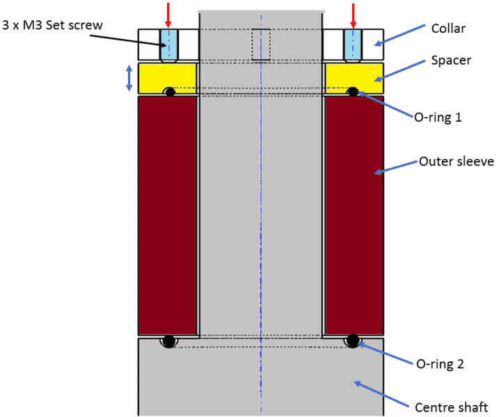

Hi,
I am working on a problem where I have to find the tightening torque required for rotating the outer sleeve. The Outer sleeve is rotated by human hand ( One hand operation) hence the sleeve torque feel is determined by the set screw.
Problem statement: Please refer the image. O-ring 1 at the spacer will compress the Outer sleeve against O-ring 2 by means of tightening the set screws in the collar. The spacer is movable (floating position) and collar is fastened with shaft (fixed position). When the set screw is tighten, the spacer moves and compress the O-ring (1) against outer sleeve.
I have to calculate, How much torque is required for set screw to tighten so that sleeve will be rotated against the O-rings (1&2). Consider it is a dry condition
Set screw = 3 nos (M3)
O-ring material = Viton
Sleeve material = Aluminum 6061-T6
Maximum Torque applied by human hand (One hand) = 9000 N-mm
Thanks in advance.
Where does the figure 9000 N⋅mm come from?
A bit off point, but, if these o-rings are for providing mechanical friction only, unless there is a chemical resistance issue, Viton is poor material for that type of application. A 60 or 90 Duro NPR (Buna N) would be a better choice for contact surface durability.
I doubt any calculation will be very accurate but will need the diameter of the O-rings and the coefficient of friction which seems hard to find.

Rubber materials have a coefficient of friction that is highly dependent on water or oil as lubricant. If the surfaces are dry, rotation of the sleeve will damage the O-rings. You need a surface with a predictable coefficient of friction that can slide without damage. I expect that when the O-ring is dry, the spacer will slide on the steel set-screw ends rather than the O-ring slide on the sleeve.
What is the purpose of the O-rings? Why do you need to rotate the sleeve by hand?

@psugumaran : Sorry but use of three separate and non locked screws adjusted individually to position an essentially floating collar to compress an O ring by an unspecified amount is not good engineering .
Use of torque values on the adjusting screws to set up the assembly even approximately correctly is in any case going to be problematic .
In this kind of assembly the proper quantities to specify are the dimensions which control the compression of the O ring .
In components which nominally touch then the compression is controlled by the ring groove dimensions .
In components which have some separation then compression is additionally controlled by the separation distance .
Ideally the components are dimensioned so that they can just be put together and then the O ring compression gets set correctly without any adjustment at all .
If it is absolutely necessary to have adjustment then a gap dimension between components can be given and set to correct value during assembly using feeler gauges .
