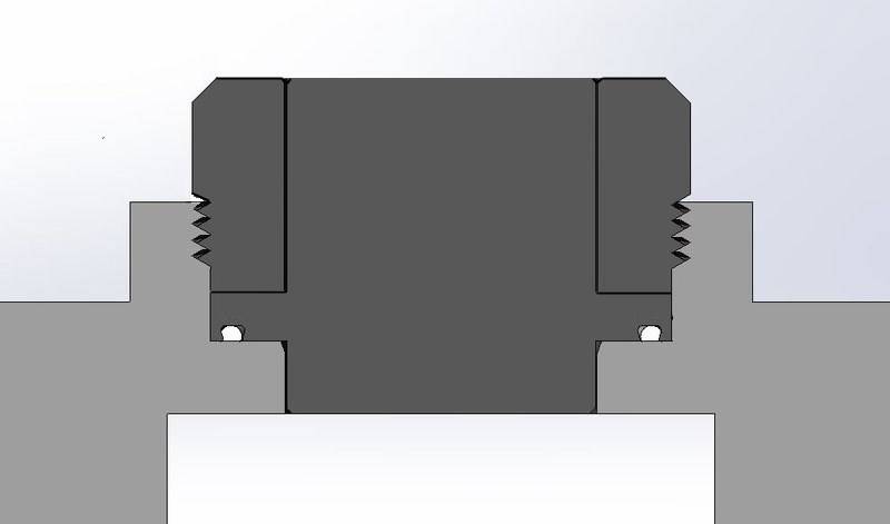

I was thinking of something like this but it's an incomplete idea. As drawn below the outer ring isn't captive to the inner. This can be solved several ways..
1) Using a screw thread. The outer ring would be screwed onto the inner until the threads become unmated. It would then look and feel captive but could in fact be disassembled by getting the threads to mate again. I've seen this done before somewhere but I just can't think of an example. If that's not clear I'll try and make a drawing to show it.
2) Length of chain. Common on dust caps for military electrical connectors.
3) Fitting a retaining disc to the top after assembly.

Taking a variation from the original design and CWatters modification, what about cutting off the threaded bushing at the bottom of thread to make it as short as possible to move his busing shoulder up in order to give the bottom bushing sufficient length to allow placing the non-rotation pin and body slot in the bottom most bore below his face sealing shoulder.
For volume production, instead of using a pin for orientation you could make the body hole 'D' shaped for instance to ensure correct orientation of the orifice insert.
For a captive assembly a slight modification of @CWatters approach would be the method used on some medicine (pill) bottles. i.e. the cap is held onto the body with a ramp in both pieces. To remove a medicine bottle cap you must line up the cap with a notch in the ramp on the bottle. Without that notch, the cap is secured.
edit: With proper geometry, the body hole and orifice insert could also be made rectangular.
