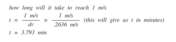

alberto91
Is this correct?
Why the time is minutes instead of seconds?
Thanks!

By dimensional analysis your t has no units.
And how can I calculate that equation?
What I mean is you're dividing two expressions with m/s as units, which cancel out. This tells you you're doing something wrong somewhere. I guess you want to use t=d/v? Then d is given in meters ( or another unit of distance) . In your case you used 1 m/s , which is not a measure of distance.
Thanks for your answer.
I want to use delta-vee (dv)
To find the time you need a relationship between velocity and time such as the definition of acceleration:
##\frac{dv}{dt}=a##
Then separate and integrate:
##dv=adt \rightarrow \int_{0}^{v_{needed}} dv = \int_{0}^{t_{needed}}a dt##
This gives
##v_{needed} = at_{needed}##
So to find the time needed to get to the needed velocity, simply divide.
##t_{needed} = v_{needed}/a##
Note that this assumes constant acceleration from zero. So it seems the solution you showed has the wrong units for acceleration.
There is context missing. Do you have a constant acceleration? If yes, what is its value? Maybe 0.2636 m/(s*min)?
