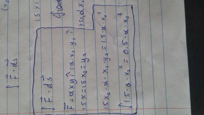

Is this correct?
Handwritten derivation of a line integral of F dot ds, with F = alpha x y-hat and 1.5x = y, leading to 1.5 alpha x2^2 and the result 0.5 alpha x2^3, shown on lined paper and rotated sideways.
That image took ages to load and came out sideways. Parts are also hard ro read. Please take the trouble to type in your algebra.
It was ok down to where you wrote out the force as a vector in hat notation You need to do the same for ##\vec {ds}## and execute the dot product.
Edit: if you cannot write LaTeX, don't worry about the arrows and hats.
