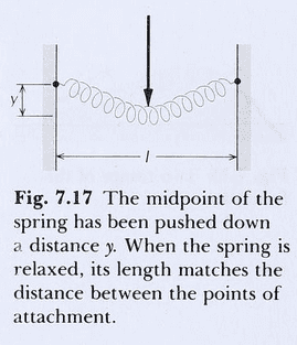

Diagram of a spring stretched between two walls with its midpoint pushed down by an arrow, labelled Fig. 7.17, with y marking the downward displacement and l the distance between the attachment points.

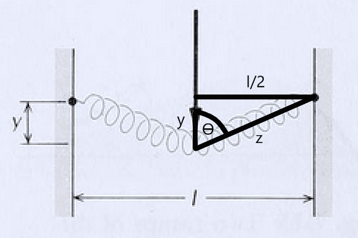

Diagram of a horizontal spring fixed between two vertical walls a distance l apart, with its midpoint displaced by y; a right triangle marks half-length l/2, the displacement y, the spring length z and angle theta.
My question is whether I've formed the integral for the work done correctly? It just seems a bit unwieldy to me...
If I call the extension of the spring ## x ##, I can see that ## z = \frac l 2 + x ## and ## z^2 = \left( \frac {l} {2} \right)^2 + y^2 ##. Combining them gives: $$ x = \sqrt {y^2 - l} $$
Since the restoring force generated by one spring is ## F_{res} = -k \sqrt {y^2 - l} ## along its axis, the force that must be exerted by me to overcome both springs is: $$ F_{me} = 2k \sqrt {y^2 - l} $$
Now, using ## W = \int |\vec F| \, \cos \theta \, |d \vec r| ## where ## cos \theta = \frac {y} {z} = \frac {y} {\frac {l} {2} + x} ## we can say that: $$ W_{me} = 2k \int_a^b \frac {y \sqrt {y^2 - l}} {\frac {l} {2} + \sqrt {y^2 - l}} \, dy $$ $$ = 2k \int_a^b \frac {y} {\frac {l} {2 \sqrt {y^2 - l}} + 1} \, dy $$
First of all your equation ##x = \sqrt {y^2 - l}## is dimensionally incorrect and that error propagates down your derivation. I'm sure that's a typo.
Why the doubling? Is this how we add vectors that have the same magnitude but point in different directions?
Don't we have to be careful about the spring constant? Imagine two springs of length ##l/2## connected in series. If the full spring length ##l## has a spring constant of ##k##, then each spring of length ##l/2## must have spring constant ##k_{l/2} = ?##

If you are allowed to use the standard formula for the elastic potential energy of a spring ##(E = \frac 12 kx^2)##, then part (a) can be done without calculus. Simply consider the total extension.

Yeah I really messed that up. Take two.
I shall replace the single spring with two identical springs, each with a spring constant of ## 2k ##. This is equivalent.
Considering one of the springs, if I call its extension ## x ##, I can see that ## z = \frac l 2 + x ## and ## z^2 = \left( \frac {l} {2} \right)^2 + y^2 ##.
Combining gives: $$ x^2 + lx - y^2 = 0 $$ Solving for x: $$ x = \frac {-l \pm \sqrt {l^2 + 4y^2}} {2} $$ I only want the positive solution, so it's: $$ x = \frac {-l + \sqrt {l^2 + 4y^2}} {2} $$ Now, the force with which I push against each spring is: $$ F_{each} = 2kx = k(-l + \sqrt {l^2 + 4y^2}) $$ The force in the ## y ## direction is: $$ F_{each_{y}} = k(-l + \sqrt {l^2 + 4y^2})\cos\theta $$ $$ = \frac {k(-l + \sqrt {l^2 + 4y^2})y} {\frac l 2 + \frac {-l + \sqrt {l^2 + 4y^2}} {2}} $$ $$ = \frac {2k(-l + \sqrt {l^2 + 4y^2})y} {\sqrt {l^2 + 4y^2}} $$ $$ = 2ky(\frac {-l} {\sqrt {l^2 + 4y^2}} +1) $$ So the work done pushing against one spring is [EDIT: inserted missing integration symbol]: $$ W_{each_{y}} = 2k \int_a^b (\frac {-l} {\sqrt {l^2 + 4y^2}} +1)y \, dy $$ And against two springs [EDIT: inserted missing integration symbol]: $$ W_{both_{y}} = 4k \int_a^b (\frac {-l} {\sqrt {l^2 + 4y^2}} +1)y \, dy $$ Does this integral look right now?

Thats what I got, but the extra algebra trying to use the extension can be avoided:
$$ F_{l/2} = k_{l/2} \left( z - \frac{l}{2}\right)$$
The vertical component of each spring is
$$ F_{y_{l/2}} = k_{l/2} \left( z - \frac{l}{2}\right) \cos \theta = k_{l/2} \left( z - \frac{l}{2}\right) \frac{y}{z} = k_{l/2} \left( 1 - \frac{l}{2 z}\right) y $$
Then multiply by 2 for each spring contribution:
$$ dW = F_{y_{l/2}}~dy = 2 k_{l/2} \left( 1 - \frac{l}{2 \sqrt{ (l/2)^2 + y^2}}\right) y~dy $$

Oh, I chose the opposite angle in my working. Didn’t notice you hadn’t picked that one in your diagram. I’ll fix it.
