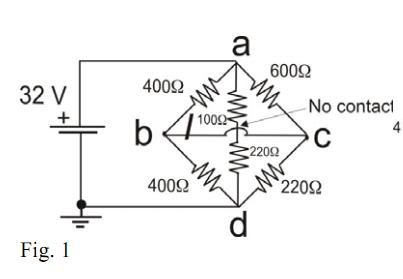

Essentially I am pursuing clues as to what I should do in order to clean up the following circuit:
Circuit schematic labelled Fig. 1: a 32 V battery feeds a bridge network with nodes a, b, c and d, resistors 400Ω, 600Ω, 100Ω, 220Ω, 220Ω and 400Ω, and a note reading No contact at the centre junction.
I'm kind of confused regarding the portion where it says "no contact". Help?
Does that mean I can merely add up the values of the resistors on lines abd and acd such that R=400+400+600+220=1620, thus Req=[(1/1620)+(1/320)]^{-1}?
No, it means that between a and b there's 400 and 600 Ohms in parallel, and between b and d there's 400 and 200 Ohms in parallel.
Imagine taking hold of point c and swinging it up out of the page and over, placing point c on top of point b. Points b and c are connected, so they're the same node, so this is not altering the underlying topology of the circuit in any way.
Alright, then it would be as follows:
R1=[(1/400)+(1/600)]^{-1}
R2=[(1/400)+(1/200)]^{-1}
R3=R1+R2, and thus Req=[(1/R3)+(1/320)]^{-1}

No. Point a is not wired to point c except via a resistor. Point a is not wired to point b except via a resistor. Only points b and c are connected together.
Points b and c are only at the same potential because they are wired together.
then of course there is no current in wire bc and and current in ab will continue to bd --- & current in ac will continue in ed ...
so i still think that we can remove wire bc ...
You can remove the wire only if you connect the resistors at c to point b. Otherwise, there will be current in the wire. A wire may carry current even if the potential at each end is the same (or as close to the same as makes no difference for low resistivity wire). The wire is forcing the potentials to equalize.
In the case of this circuit, if you ignore the two central resistors and solve the remaining loops for the currents, you'll find that there's about 20 mA flowing from b to c through the wire.
So essentially the effective resistance should be R=174.
Yes. 174.1Ω (don't forget your units).
If you carried out all the operations using fractions, you'd find 2960/17 Ω. :smile:

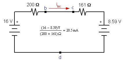

It's not as simple as that. There are two voltage dividers involved, so it's what's known as a 'bridge circuit'. They influence each other. Note that you could also have chosen the path acbd and obtained a different result.
One way to solve for the current is to convert each of the voltage dividers and the supply voltage into an equivalent Thevenin model. You end up with a series circuit with two batteries and two resistors. Easy. I've attached a picture.
  • Circuit schematic: a 16 V battery on the left and an 8.59 V battery on the right in a loop, with a 200 Ω resistor and a 161 Ω resistor on the top branch, nodes b and c between them, and node d on the bottom. Arrow labelled i_bc points from b to c. Text reads (16 − 8.59)V / (200 + 161)Ω = 20.5 mA.
How exactly did you come up with the Thevenin equivelant in this picture? Couldnt you just find the current from abcd and then subtract the current from acbd?
32V battery and voltage divider abd. Thevenin equivalent between points b-d.
32V battery and voltage divider acd. Thevenin equivalent between points c-d.
Why don't you try your method and see if the results match?
Right. That's because the currents split at the b and c junctions. So in your proposed path abcd, the current also has a path via bd that is not being accounted for. A similar situation holds for the path acbd, where the cd path is overlooked.

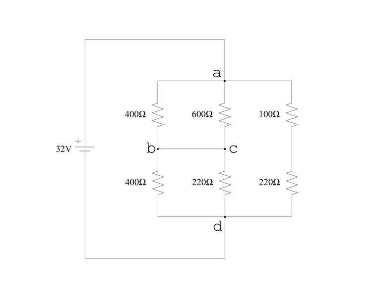

You could redraw the circuit as in my attachment.
