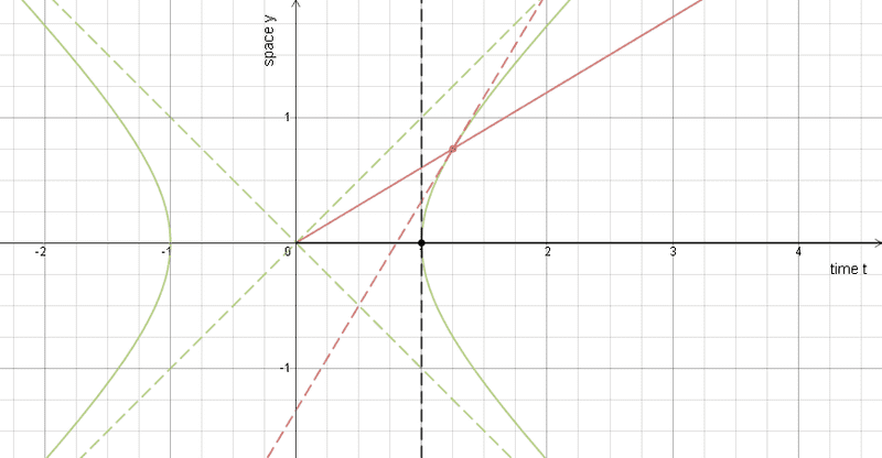

Yes, you can easily normalise arbitrary axes in a Minkowski diagram by drawing the hyperbolae ##x^2 - c^2 t^2 = \pm 1##. Just as you could normalise rotated axes in Euclidean space by drawing the circle ##x^2 + y^2 = 1##.

In old related threads ( here and here ), I posted my diagrammer https://www.desmos.com/calculator/ti58l2sair
which could be modified to draw fancier diagrams.
Minkowski spacetime diagram with time t on the horizontal axis and space y on the vertical axis, showing a green hyperbola pair with dashed asymptotes, a dashed black vertical line at t=0, and red lines through the origin.
There is a way to do quantitatively correct diagrams without explicitly using hyperbolas or detailed calculations.

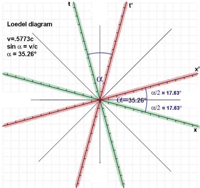

That's no reason for not using them. If you need only two frames to deal with (as is mostly the case in exercises) there is no reason to use a Minkowski diagram. In a Loedel diagram it's a lot easier to consider each frame at rest because none of both frames has orthogonal axes. A layman often never gets that far with a Minkowski diagram where the orthogonal x,t frame is often erroneously treated as a preferred 'at rest' frame.
It's very easy to draw a two frame spacetime diagram with identical unit lengths. All you need is calculating the angle. Then make your own unit length as you like. But remember: the unit length is only valid for the two frames (don't be tempted using it on the vertical and horizontal grey orthogonal lines).
An Loedel example for v=.5773c:
Loedel diagram with v=.5773c, sin α = v/c, α = 35.26°: green t and x axes and red t' and x' axes, both pairs symmetric about grey diagonal lines, with α/2 = 17.63° marked.
