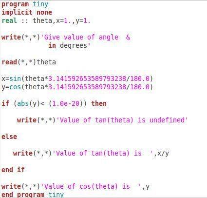

Hi
I am doing a program using gfortran compiler. I feed angle theta in degrees to the program. Program is supposed to calculate the value of tan(theta) using values of sine and cosine of theta. the program should give warning of division-by-zero if magnitude of cosine theta is less than 10-20. I have attached the code in jpg file...
When I feed theta=90, the cosine value takes values like 4.37E-8 , so tan theta is always calculated...how can we rectify this ?
thanks
I have never had those kinds of issues since the numbers I deal with are mostly reasonable...but your problem sounds like the type of variable that you are using does not even have the resolution to get that small...any lower than 4e-08 and it may go negative, I guess...so, you need to read up on KIND, I have never used it, but what I remember reading, you should be able to choose the accuracy you want your variables be able to handle.
You also need to change your constants to double precision. 3.14159... is a single precision number so the compiler will effectively ignore everything after about 6 significant figures. 3.14159...d0 is double precision (about 16 significant figures).
Actually, if you just changed those "pis" to double precision the code would probably do what you expect, but mixing up single and double precision is usually a bad idea in "real" programs, so learn how to do this example the right way!

Hey IssacNewton and welcome to the forums.
This kind of thing occurs in computer game engine design and the simple way to deal with this is to basically use a higher-precision data type and then use a routine to check if something is less than a fixed value to zero and if it is, to set it to zero.
So as an example, your threshold is 0.000005d. Then if your value is less than this number, the number becomes zero.
You can do this kind of thing for values in general, but this is a common way that it is handled in things like game engines.
ok thanks everyone. I may have to use double precision variables I guess... But the book I am using (Fortran 95/2003 for scientists and engineers- Chapman 3ed.) has not started talking about double precision at this point (chapter 3). And this is a problem from chapter 3...
