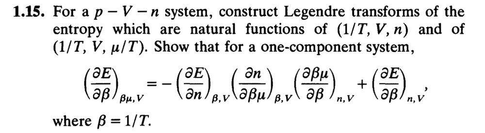

See image below
##dS = \beta(dE - \mu dn +PdV)##
##\frac{\partial x}{\partial y}\Big \rvert _z = - \frac{\partial x}{\partial z}\Big \rvert _y \frac{\partial z}{\partial y}\Big \rvert _x##
(Maybe relevant maybe not.)
So the Legendre transforms are straightforward; define ##S_1=S-\beta E## and ##S_2= S-\beta E + \beta \mu n## then we get:
##dS_1 = -Ed\beta - \beta \mu dn + \beta PdV##
##dS_2 = -Ed\beta + nd(\beta \mu) + \beta PdV##
And so by applying the equality of mixed partials of ##S_1## and ##S_2## we can conclude (similar to the Maxwell relations)
##\frac{\partial E}{\partial n }\Big \rvert _{\beta , V}=\frac{\partial (\beta \mu)}{\partial \beta }\Big \rvert _{n , V}##
##\frac{\partial E}{\partial (\beta \mu)}\Big \rvert _{\beta , V}=-\frac{\partial n}{\partial \beta }\Big \rvert _{\beta \mu , V}##
I feel like these must be relevant because why else would he mention those Legendre transforms in the same problem. However I cannot figure out how to derive the given formula. I tried a lot of things (no point in typing them) that didn’t lead to it. I mention the “maybe relevant” equation because it was used in the same chapter.
Thought about it for more than a day with no new ideas. Thanks in advance.
This is a long one, with all of the partials, and would take all day to write out in Latex, but I think I verified it to be correct. Let me summarize: Take ## E_1(\beta,V, \beta \mu )=E_2(\beta,V, n) ##. The problem is to take ## \frac{\partial{E_1}}{\partial{\beta}}_{V,\beta \mu} ## and you do it on ## E_2 ##. You write ##n=n(\beta,V, \beta \mu) ##. It helps to write differentials ## dE=dE1=dE_2 ## and write out all of the terms. You also write a differential for ## dn ##, and it gets a term with ## d (\beta \mu ) ##. You then write ## \beta \mu=\beta \mu (\beta, V,n) ##, and write out the differential for ## d (\beta \mu) ##. You have two degrees of freedom, so let ## dV=dn=0 ##. This gives ##(\frac{\partial{n}}{\partial{\beta}})_{V, \beta \mu}=-(\frac{\partial{n}}{\partial{\beta \mu}})_{\beta,V} ( \frac{\partial{\beta \mu}}{\partial{\beta}})_{V,n} ##.

You said a couple things I didn’t follow, like how you mentioned to take ##\beta \mu## to be a function of ##(\beta, \mu, n)##, and how you said something was equivalent to my x,y,z formula.
But what I mainly gathered is that you took ##E_1(\beta, V, \beta \mu) = E_2(\beta, V, n(\beta, V, \beta \mu))## and then differentiated w.r.t beta (effectively using the chain rule) to conclude:
##\frac{\partial E_1}{\partial \beta }\Big \rvert _{\beta \mu , V} = \frac{\partial E_2}{\partial \beta }\Big \rvert _{n, V}+\frac{\partial E_2}{\partial n }\Big \rvert _{\beta, V}\frac{\partial n}{\partial \beta }\Big \rvert _{\beta \mu, V}##
That’s a great starting point, but the main thing I didn’t understand is how did you conclude the following:

Oh wow I just realized what you meant! It’s not a Maxwell relation it’s the x,y,z relation! Wow. So it was relevant after all hahah.
Well then I guess that solves it! Thanks so much!
