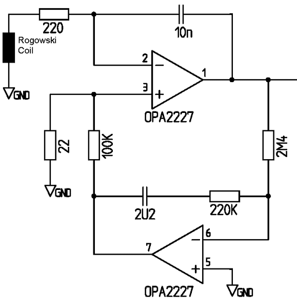

hiii guys
im doing my FYP on amplify the voltage from a rogowski coil
just to make it short
i have already design the coil
which can detect a 50k frequency and gives pick-to-pick = 10mV Ac
now, i have to design an amplifier that can give an actual value.
so, i have already got a circuit that can be use for this type of current measurements
and my problem is to recalculate it to make it suitable for my coil
and I am using LT1630 Op amplifier
thanx a lot

The integrator first stage makes sense for a Rogowski coil, but I don't understand what the 2nd opamp in the feedback path is for. Can you explain the circuit to us?
yeah even me i didnt get it well
but they explain to me and said
" The PI feedback adds a 2nd order high pass to the integrator characteristic. The capacitor sets the second high pass corner at
about 0.3 Hz, the first at about 1.4 Hz is set by the feedback gain. To get a suitable roll-off behaviour, both corner frequencies
have to be scaled "
that what i under stand from them
is there is another way to rearrange this circuit and make it easy for the calculation ?

The feedback element in your input amplifier is a 10 nF capacitor, which has an impedance of =-318j ohms at 50 kHz, but is open at dc. The LT1630 opamp has an open loop gain of ~3500 volts per millivolt at dc, so a very small input offset voltage will produce a dc current that will be integrated by the 10 nF capacitor, causing the amplifier output to hit the rail in a few seconds. As one example, suppose the input voltage offset is V =1 microvolt. Then the current through the Rogowski coil and the 220 ohm resistor will be V/220 = I =4.5 nanoamps. The voltage slew rate across the 10 nF capacitor is then dV/dt = I/C = 4.5 microamps/ 10 nF = 0.450 volts per second. The amplifier output will hit the rail in less than 50 seconds. The easiest correction to the amplifier is to put a 50k-ohm resistor in parallel with the 10 nF capacitor. In this case, the dc gain is 50k/220 = 227, so a 1 microvolt input offset will produce a 0.227 millivolt output offset.
If this dc output offset is not a problem, then use the 50k resistor. A large ac capacitor (~1 uF) in series with the 220-ohm resistor will help, but not completely prevent the 10 nF capacitor from integrating any residual input voltage and current offsets.
What kind of signal are you trying to measure with the Rogowski coil? Do you have a specific application in mind? Rogowski coils are usually used to measure the dc magnetic fields around wires carrying large dc currents. Are you trying to measure an ac magnetic field at 50 kHz, or a rapidly changing magnetic field? Or is this an antennal for receiving a 50 kHz electromagnetic (transmitted) wave?
So, thoroughly evaluate the dc characteristics of your circuit, including all input offset currents, input offset voltages, and input voltage temperature coefficients.
Bob S.

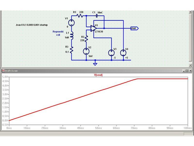

Hi abadi-
I have attached a dc (no ac signal) spice model for your Rogowski coil application. V1 is the Rogowski coil output (= 0 volts for this analysis), L1 and R3 are the coil inductance and resistance (place holders) and V2 is a 1 microvolt input voltage offset. C1 = 10 nF is the feedback capacitor. When the amplifier is turned on, the output voltage ramps up to the positive rail in 70 milliseconds.
Questions: Why does it ramp up to the positive rail, and what are you going to do about it?
Bob S

and about your question ...
ramp at the positive rail, becouse we are using only positive side,
what to do,,, i just know it in hardware , which is to use 2 batteries !
am i right ?

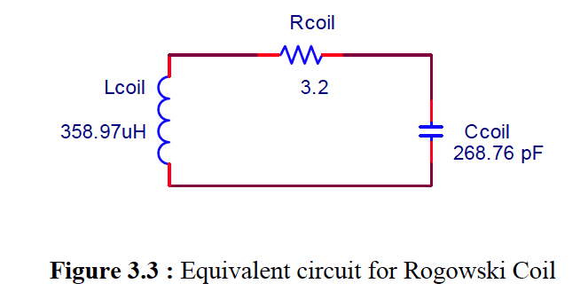

Please look at the Rogowski coil in the picture in
http://en.wikipedia.org/wiki/Rogowski_coil
It is an air-filled toroidal coil that has only coil inductance, coil resistance, and perhaps inter-turn capacitance at very high frequencies. It is usually connected to the amplifier with no series capacitance. Variations of this design for picking up low frequency magnetic fields are flat multi-turn coils with inductance, coil resistance, and inter-turn capacitance at very high frequencies. It is usually connected to the amplifier with no series capacitance.
Please completely describe your concept of a Rogowski coil. Where is the capacitance?
Please look at Figure 2 in this paper:
http://homepage.ntlworld.com/rocoil/Pr7o.pdf
and note in particular the Rf in parallel with the integrator capacitor. (Rogowski coils are (usually) always used with integrators). What is the resistor for? Why is your circuit different than the one in Figure 2?
Bob S
you can see my equivalent circuit for rogowski coil at the attachment
i have tired that amplifier, and it doesn't work, that's why I am using different circuit that i got it from different Forum.
and now I am trying to modify it to let it suitable for my project

Both integrating amplifier stages in your original post are open-loop dc, meaning that both dc amplifier gains are over 3,500,000, and this has to be fixed. You should calculate and simulate (Spice model) the effects of dc input offset currents and offset voltages, and the effect of the input voltage offset coefficient (see my previous post #18 on Spice model of output voltage ramp). The equivalent curcuit of your Rogowski coil is self-resonant at ~ 500 kHz. What is your application, and what frequencies are you trying to measure? The Rogowski coil L and C can be modified to match the application. Your first circuit should be a basic integrating Rogowski coil circuit with leakage feedback resistor Rf, and without the extra active feedback circuit. Once that is working, then you can add the extra active feedback.
Bob S

Hi abadi-
You first need to get the integrator opamp working without the feedback opamp connected.
1) In original circuit, remove the 100k resistor and the second opamp from circuit.
2) Change the 22 ohm resistor to a 220 ohm resistor.
3) Put a 50k ohm resistor in parallel across the 10 nF capacitor.
4) In your original circuit as posted, you need symmetric + and - supply voltages (+/- 5 volts minimum) to the integrator op amp.
5) Now, without the Rogowski coil connected, the output of the integrator opamp should be less than a volt or two.
6) If 5) doesn't work, then change 10 nF capacitor to a 100 nF (0.1 uF) capacitor and retry.
7) If 5) works, then attach Rogowski coil. The output should still be less than several volts.
8) Post a complete copy of your new circuit, and discuss results.
Bob S
ooooo
my problem was, i test the amplifiers together
