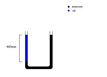

Determine the pressure required to make the top of the oil, with height H0=443 mm even with the height of mercury. The oil has relative density.920 and mercury has relative density13.55. To which side is the pressure applied?

There is a pressure being applied to one tube of the manometer. The pressure has to suffice to balance the difference in the weights of the contents of the two tubes. Think about force balance at the bottom of the manometer.
but i don't know the force being applied at the top am i crazy or are they too many unknowns?
Pressure is force per unit area. The mg force it needs to balance is g*density*volume=g*density*length*area. You can put in symbolic variables for area and length. You will find in the end you don't need to know them because they will cancel.
hmmm maybe this might help better than my sketchy diagram(see attachment)...
i still don't know how to calculate
P="rho"*g*h
but how do i calculate "rho" if i only have the relative density

Relative density is referring to a multiple of the density of water. It's not all that 'relative'. It's usually called 'specific gravity'.
Good question! I guess they mean "specific gravity" or the question cannot be answered. I'm sorry -- I translated "relative density" into "specific gravity" when reading the question.
ok so pgh-Patm = P?
please help me its 3am here... i just need someone to actually explain how to get to the answer, because my teacher is a dick. and i hate university with a passion
Weight/area is rho*g*h, if that's what you mean. And don't worry about Patm - you are just worried about a pressure difference. And the pressure difference has to support the weight difference between the two tubes.
