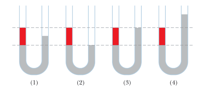

The figure below shows four situations in which a red liquid and a gray liquid are in a U-tube. In one situation the liquids cannot be in static equilibrium. (a) Which situation is that? (b) For the other three situations, assume static equilibrium. For each of them, is the density of the red liquid greater than, less than, or equal to the density of the gray liquid?

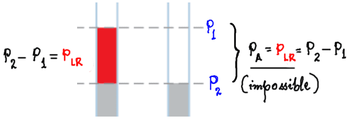

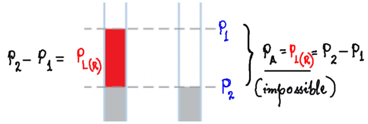

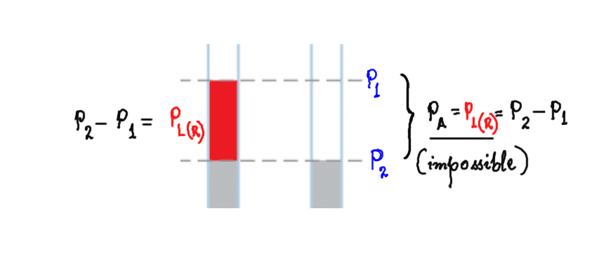

(a) Situation (2) is my answer (which cannot be in static equilibrium). The pressures in the lower dashed line (##P_2##) has to be the same on either side (for equilibrium). That means the pressure due to the red liquid is equal to the pressure due to the same length of air column (length), which is not possible. I explain a bit in the cropped diagram shown below. ##P_A## = Pressure due to air and ##\color{red}{P_{LR}}## = Pressure due to red liquid.

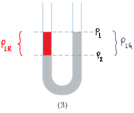

Situation 3 is shown alongside.
Arguments are the same as before, focussing on equality of pressure ##P_2## on both sides which imply again that ##\color{red}{P_{LR}} = \color{grey}{ P_{LG}}##. But in this case since the liquid colums have the same heights, we conclude that ##\boxed{\color{red} {\rho_{LR}} = \color{grey}{\rho_{LG}}}##.Situation 4 is shown alongside.

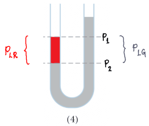

Agin the arguments are same as above. Focussing on pressure ##P_2##, we find that the higher level of the grey liquid column must imply that it has a lower density than the red liquid, or ##\boxed{\color{red} {\rho_{LR}} > \color{grey}{\rho_{LG}}}##.
