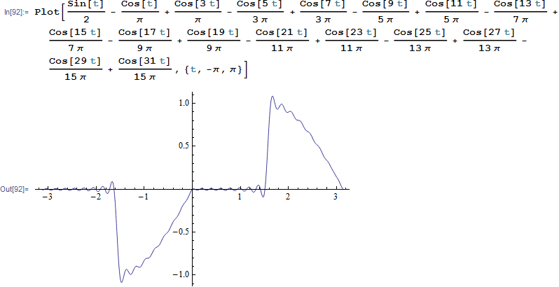

Here's a plot:

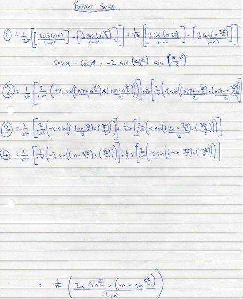

I have calculated a0 = 0, which i found straight forward, and i have the calculation for an down the following:
an = 1/2π x[ [ ( (2 cos(nπ) ) / (1-n2) ) - ( (2 cos(n π/2) ) / (1-n2) )] + [ ( (2 cos(n 2π) ) / (1-n2) ) - ( (2 cos(n 3π/2) ) / (1-n2) )] ]
Does that look correct thus far can someone tell me?

Without the code, that's very hard to follow. My working is attached.
In post#15 milesyoung gave a link to a WolframAlpha calculation of a table of coefficients. Have you confirmed that your expression can match the given values? It would be unproductive to continue hammering away at trig identities if the initial expression is not correct.
I am trying to generate an expression for an - that's what I'm halfway through.
It looks to be in the right ballpark, but I've hit an impasse collapsing the expression. My working out is in post #28. I think i am losing the will to live!
