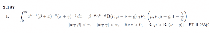

Hello all,
I need to evaluate this integral
[tex]\int_0^{\infty}(1+\alpha_2)^{-2}\left(\alpha_2+b\right)^{-1}\,d\alpha_2[/tex]
I found the following integral in the table of integrals (eq 3.197.1, 7th edition)
[tex]\int_0^{\infty}x^{v-1}(\beta+x)^{-\mu}(x+\gamma)^{-\rho}\,dx=\beta^{-\mu}\gamma^{\mu-\rho}B(v,\mu-v+\rho)_2F_1(\mu,\,v;\,\mu+\rho;1-\frac{\gamma}{\beta})[/tex]
The integral and the conditions are in the image attached. Comparing the two integrals I set ##v=1,\,\beta=1,\,\gamma=b##, which implies that ##\mu=2## and ##\rho=1##. I satisfy the last two conditions, but I'm not sure about the first two. What does it mean arg x if x is a constant?
##b## varies in a loop, and when I evaluate the integral I get results. However, the final result, in which the above integral is a part, isn't right. I'm not sure where the error is, and I wanted to make sure it isn't in using the integral.
I appreciate any help. Thanks

It doesn't say arg(x) in the integral you found -- it says arg(β) and arg(γ). This implies that these parameters are complex. In the integral x is real.

The integral you found should work, but I don't know what the B and F1 functions are. The integral could be evaluated using much simpler means, though, by using partial fractions decomposition to split the integrand into three parts.

The equation is valid for some complex numbers as well, the condition on the complex argument are satisfied for positive real values (and also for all complex values with a positive imaginary component).
It is not necessary to use such a powerful formula, for integer exponents you can use partial fraction decomposition.
