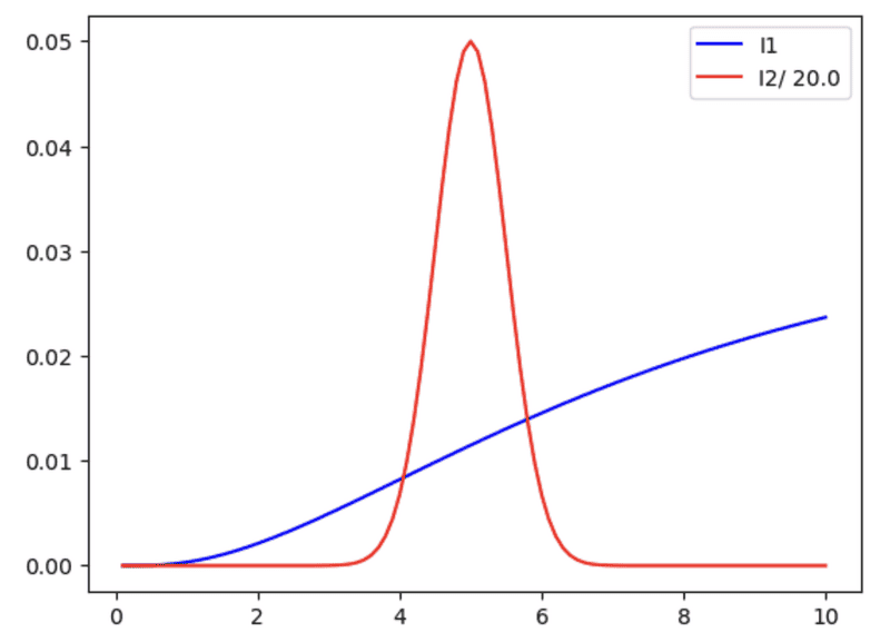

You may have to do it numerically, or use some approximations. Are the values of alpha, beta, mu and sigma completely arbitrary, or do you have some prior knowledge of what they are? For example, for alpha = 5, beta = 0.5, mu=4.0, sigma=1.0, the second term (the Gaussian) is much narrower than the first term with the log. So you could approximate the first term with a linear function. Then the integral is easy. But this depends on the values of the constant terms. If they are completely arbitrary, it would be pretty easy to build a numerical function that will return the value of the integral given the four constant terms.
  • Line plot with x-axis from 0 to 10 and y-axis from 0 to 0.05. A blue curve labelled I1 rises steadily from near 0 to about 0.024 at x = 10. A red curve labelled I2/ 20.0 is a narrow peak centred near x = 5, reaching about 0.05, and is close to 0 elsewhere.
