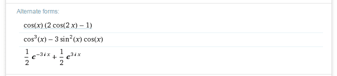

How to express ##\cos 3x## as a polynomial in ##\cos x##?
DrClaude said:
Look up http://www.wolframalpha.com/input/?i=Cos[3x] under "Alternate forms"

basty said:
##= \cos x (\cos^2 x - \sin^2 x) - \sin x (2 \sin x \cos x)##
Simplify the line above and you get the answer from WolframAlpha. You can then convert the ##\sin^2 x## to get a polynomial in ##\cos x##.
