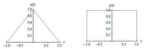

Suppose that [itex]y(t)=x(t)\ast h(t)[/itex].
([itex]\ast[/itex] denotes convolution)
Here are the signals:
How to find h(t) in time domain? Does there exist such h(t)?
Thanks in advance.

Anyway, here is my attempt:
$$\mathcal{F}\left \{ x(t) \right \}=sinc^2(f)\; ;\: \mathcal{F}\left \{ y(t) \right \}=2sinc(2f)$$
$$\mathcal{F}\left \{ h(t) \right \}=\frac{\mathcal{F}\left \{ y(t) \right \}}{\mathcal{F}\left \{ x(t) \right \}}=\frac{2sinc(2f)}{sinc^2(f)}=4\pi f\cot(2\pi f)$$
I guess that this function has no inverse Fourier transform, and thus there is no LTI system with x(t) as input and y(t) as output. Is this correct? If yes, how to prove?

Think of it this way...
1 - What kind of circuit would convert your x(t) to your y(t)?
2 - Next, what would be the impulse response of that circuit? This would be your h(t).

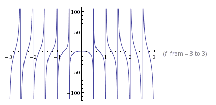

When the plot is as follows, I don't know how to do the integration, if the integral exists.

You're not integrating the function you sketched, which I presume is your H(f).
You're trying to integrate ∫H(f)ejωtdf over f = -∞ to f = +∞ with ω = 2πf.
Of course, that's h(0). Can you help me on this integration?

I'm wondering about your initial approach, now that I've looked at it some more.
Looking at your x(t) and y(t) graphs, and taking the Fourier integrals of both,
X(w) = (1/2π)∫(t+1)exp(-jwt)dt from t= -1 to 0 + (1/2π)∫(1-t)exp(-jwt)dt from t= 0 to +1.
Similarly,
Y(w) = (1/2π)∫exp(-jwt)dt from t = -1 to +1.
Then H(w) = Y(w)/X(w) and finally
h(t) = ∫H(w)exp(jwt)dw.
I tried to do the X(w) integration and found it pretty messy, which means subject to making mistakes. I used ∫eaxdx = eax/a and ∫xeaxdx = (eax/a2)(ax-1).
The Y(w) integration is of course much simpler. The h(t) inverse integral promises to be messy also.
So, best I can do for you is to suggest either you try to muddle through the integrations, or get a table of Fourier integrals like the one I recommended previously. I wish I had that table but I don't.
Of course, it may be that the best approach is graphic convolution, but I'm not inclined to try that myself.
