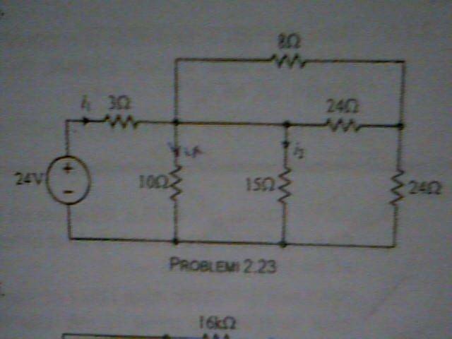

We the circuit that I have attached in the post.I have to find i1 and i2. So,to find i,I have to find the equivalent resistance and then divide the voltage by the resistance and find the current.So i take the resistances 15 Ohm and 10 Ohm like they are in parallel and 8 Ohm and 24 Ohm like they are in parallel too.I add this one to the 24 Ohm on the right.Then I take this and the (10 ||15) in parallel.I add the little 3 Ohm.Then we have an equivalent 8 Ohm.SO i1=8 Ohm.Awesoome.The problem is ,how to find i2 now?
Note : If it is not clear in the figure,i1 is near 3 Ohm and i2 is near 15 Ohm.
  • Circuit schematic labelled Problem 2.23: 24V source with 3Ω, 10Ω, 15Ω, 8Ω, 24Ω and 24Ω resistors, with currents i1 and i2 marked.
In future, please use the posting template.
If you know i1, then you know the drop across the 3Ω resistor...
Elaia06 said:
And how would that help me?
It helps because you can find the potential drop across the 3Ω resistor.
Hehe,I get it,but how would finding that potential help me find i2? Give me a little hint :)
What else is connected to the other end of that resistor?

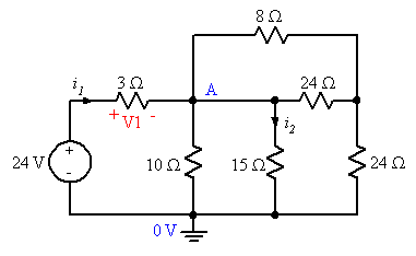

Take a look at this diagram:
Circuit schematic with a 24 V source, 3 Ω resistor, node A, 8 Ω, 24 Ω, 10 Ω, 15 Ω and 24 Ω resistors, labelled V1, i1 and i2, with the bottom rail marked 0 V.
You can find the potential drop V1 across the 3Ω resistor. So what's the potential of node A with respect to the reference node?
  • Circuit schematic with a 24 V source, 3 Ω resistor with V1 marked across it, node A, 8 Ω resistor on top, 10 Ω, 15 Ω and 24 Ω resistors, 24 Ω on the right, current i2 in the 15 Ω branch, and a 0 V reference node at the bottom.

What potential drop did you find for V1 (across the 3Ω resistor)? Do a "KVL walk" from the reference node, up through the voltage source, through the resistor to node A, summing the potential changes.
