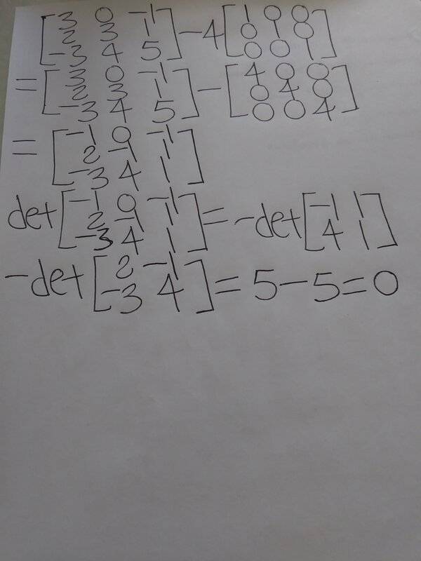

Is lambda=4 an eigenvalue of the given matrix? If so, find one corresponding eigenvector.
None.
The determinant is 0, which means that A-4I has a nullspace, and there is an eigenvector with eigenvalue 4. In the textbook, the answer says "Yes, [1, 1, -1]" for this problem. But I don't know how to find the corresponding eigenvector for this problem. Below is my work.
Handwritten question: Is λ=4 an eigenvalue of the 3x3 matrix with rows [3 0 1], [3 3 1], [-3 4 5]? If so, find one corresponding eigenvector.
Handwritten matrix calculation: a 3x3 matrix minus 4 times a 3x3 identity-like matrix, equal to a matrix with entries -1, 0, -1 / 2, -1, 1 / -3, 4, 1 (hand-drawn), then determinant expansions reducing to -det of a 2x2 matrix equal to 5 - 5 = 0.
You have to find a vector ##\vec{v}\neq 0## such that ##(A-4I)\vec{v}=0##. Can you solve this equation system?
Solve ##\begin{bmatrix}-1&0&-1\\2&-1&1\\-3&4&1\end{bmatrix}\cdot \begin{bmatrix}x\\y\\z\end{bmatrix}=\begin{bmatrix}0\\0\\0\end{bmatrix}## for ##x,y,z##. Then you get one or more solutions which are eigenvectors to ##4##. I don't know the other eigenvalues though.

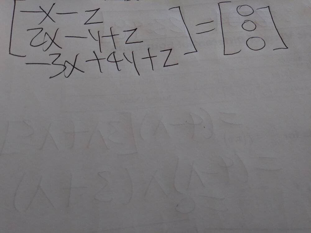

But I didn't get the answer from the book. As a result, I got x=y=z=0, the book says x=1, y=1, z=-1.
Handwritten 3x3 matrix times column vector (x, y, z) equals zero column vector: rows -x - z, 2x - y + z, -3x + 4y + z.
You get ##x=-z## from the first row. This makes ##-2z-y+z==-y-z=0## the second row and thus ##y=-z##. Do they solve the third equation, too? And if so, how do we handle ##z##?
@Math100 Eigenvectors are by definition nonzero. You are looking for a solution to ##(A-4I)x=0## other than the trivial solution ##x=0.##
You will find, when solving for the eigenvectors, that there isn't a single (non-trivial, ν=0) solution. This is because all vectors in the same direction as an eigenvector satisfy the basic requirement that Aν=λν, since these are linear transformations ( A(kν)=kAν for any scalar k). So, we would normally arbitrarily assign a value to one component. Like x=1, for example, and then solve for the others (everyone always chooses x=1, it seems). You could express it as (1,1,-1)T, (2,2,-2)T, etc., or as (x,x,-x)T (which, of course, is x⋅(1,1,-1)T). These are all solutions.
