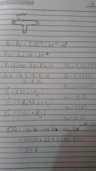

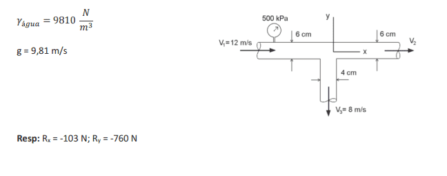

So, I need to find the X and Y components of the force in the T section
Due the fact that the problem dosn't ask for a specific force I couldn't think in any other equation to use, because even tough there is Pressure and Gravity acting I need to decompose the overall sum of it, that as far as I know should be given by the equation above.

(V12)/2 + g*z1 + P1/p = (Vj2)/2 + g*zj + Pj/ 1000
z1=z2 V1= 12 P1=500 kPa and p = 1000
72+500 = (Vj2)/2 + Pj/ 1000
572= (Vj2)/2 + Pj/ 1000
That's what I can come up with. But I still can't understand what I should do with it and where the pressures in the exits of the tube will be necessary.

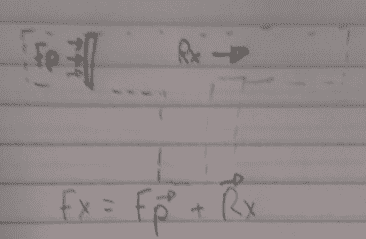

And after further reading I'm questioning if the result I've got isn't Fx , which would be equal to Rx + Fp = Rx + 500 kPa* A1

I don't confirm your answer for the pressure at the junction. I get ##P_j=87.5\ kPa##. Please check your arithmetic.
There is a more accurate way of doing what we've been trying to accomplish (rather than by trying to estimate the pressure at the junction), by treating the inlet stream as being comprised of two entirely separate flow streams of volume flow rates of ##Q_2## and ##Q_3##. This approach will immediately enable us to determine the pressures at the exit cross sections 2 and 3. Applying the Bernoulli equation to these two separate flow streams, we have $$\frac{P_1}{\rho}+ \frac{v^2_1}{2}=\frac{P_2}{\rho}+\frac{v^2_2}{2}\tag{1}$$$$\frac{P_1}{\rho}+ \frac{v^2_1}{2}=\frac{P_3}{\rho}+\frac{v^2_3}{2}+gy_3\tag{2}$$where ##-y_3## is that depth of the exit at cross section 3 (and is a positive number, so ##y_3## is negative). From Eqn. 1, I calculate that ##P_2=86.5\ kPa## and from Eqn. 2, I calculate that ##P_3=(90.0-9.81y_3)\ kPa##. What do you obtain?
The next step is to carry out momentum balances in the horizontal and vertical directions to get the reaction forces.
