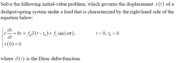

Hi there. I came to join this forum to seek help, because I can't solve the following homework question:
The solution to this can be split in 3 right?
1. the homogenous
#1:
Eq:=
c*x' +k*x =0
Characteristic:
c*r+k=0 --> r=-c/k
Homogenious solution:
y(x) = A*exp((-(c/k)*x))
initi. condit X(0) = 0 --> A=0 ?? Homogen sol = 0??
2. part sol. 1: the left hand side is equal to fc sin (wt)
3. part sol. 2: the diract delta function.
But I just can't figure out how to integrate the dirac delta function. I thought of using impartial integration but I am not sure...
please help!

The basic strategy is this:
1. Find the solutions for 0≤t<t0 (region I) and for t>t0 (region II). This means finding the general solution to the differential equation
$$c\frac{dx}{dt}+kx(t) = f_c\sin\omega t.$$ The delta function is equal to zero when 0≤t<t0 and for t>t0 so it doesn't appear on the right-hand side.
2. Apply any boundary or initial conditions to determine whatever arbitrary constants you can.
3. Match the two solutions at t=t0. You do this by integrating the differential equation from t-ε to t+ε and taking the limit ε→0+. When you do this, you'll find what the discontinuity in x(t) should be at t=t0.

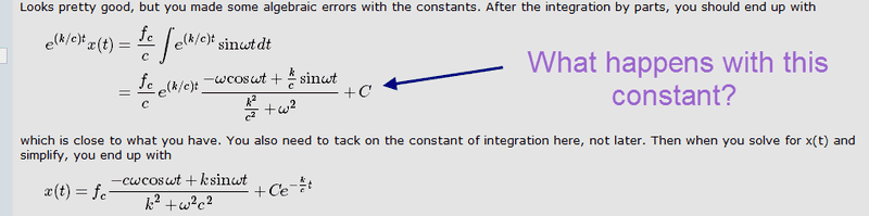

Looks pretty good, but you made some algebraic errors with the constants. After the integration by parts, you should end up with
\begin{align*}
e^{(k/c)t}x(t) &= \frac{f_c}{c}\int e^{(k/c)t} \sin\omega t\,dt \\
&= \frac{f_c}{c} e^{(k/c)t} \frac{-\omega\cos\omega t + \frac{k}{c} \sin \omega t}{\frac{k^2}{c^2}+\omega^2} + C
\end{align*} which is close to what you have. You also need to tack on the constant of integration here, not later. Then when you solve for x(t) and simplify, you end up with
$$x(t) = f_c \frac{-c \omega \cos \omega t + k \sin\omega t}{k^2+\omega^2c^2}+C e^{-\frac{k}{c}t}$$ The first term is the particular solution. The last term is the homogeneous solution. When you use this technique, the homogeneous solution is automatically included.
So you have a solution for each of the two regions:
\begin{align*}
x_1(t) &= f_c \frac{-c \omega \cos \omega t + k \sin\omega t}{k^2+\omega^2c^2}+C_1 e^{-\frac{k}{c}t} \\
x_2(t) &= f_c \frac{-c \omega \cos \omega t + k \sin\omega t}{k^2+\omega^2c^2}+C_2 e^{-\frac{k}{c}t}
\end{align*} where x1(t) is for 0≤t<t0 and x2(t) is for t>t0.
Hmm yeah I understand that the constant was at that moment (forgot to put it in, so I add it later). But what I don't understand is:
When you solve the system for its INITIAL boundary condition you get C = (f *omega *c)/ (k^2+c^2*omega^2)
When you bring over the factor of exp(kt/c) from the left-hand side, it becomes the homogeneous solution.

You have dx/dt + kx = f_c \sin(\omega t) for t &lt; t_0 \text{ and } t &gt; t_0, so you need to figure out what happens as you go through t = t_0. The presence of the δ function on the right indicates that the derivative dx/dt has a spike at t_0, which essentially means that x(t) has a jump discontinuity at t = t_0. The standard tool for seeing what conditions hold is integration: integrate the DE from t_0 - \epsilon to t_0 + \epsilon. On the left we have O(\epsilon) + \int_{t_0 - \epsilon}^{t_0 + \epsilon} \frac{dx(t)}{dt} dt = O(\epsilon) + x(t_0 + \epsilon) - x(t_0 - \epsilon), where O(\epsilon) stands for terms of size linear in ε. On the right we have O(\epsilon) + f_p. Taking \epsilon \rightarrow 0 gives
x(t_0 +) - x(t_0 -) = f_p.
