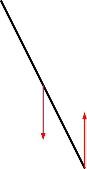

Things start well in post #1with ##2mg## down acting at the center of mass of the whole contraption -- awkward place, but probably cancels anyway. Easier to deal with if we use symmetry and look at one leg only: ##mg## halfway the ladder. (You can see I'm too lazy to carry the 2 around, so I use m for the mass of one leg only).
[edit:} Can't do that: too confusing.
Things start well in post #1 with ##mg\ ## down acting at the center of mass of the whole contraption -- awkward place, but probably cancels anyway.
Easier to deal with if we use symmetry and look at one leg only: ##{1\over 2}mg\ ## halfway the ladder. Straight down.​
Then a second force "normal force ##mg\; \cos\left ( (180^\circ - \theta)/2 \right )## up (relative to the surface of the leg) " -- here you can see how useful a picture would have been ! As well as a bit of basic trig: ##\cos (\pi/2 - \alpha) = \sin\alpha##. Apparently we are projecting ##mg## (That is the actual normal force) on a line perpendicular to the leg. For the right leg would point a bit up and to the right. Project that onto the floor and presto: there is a horizontal component where there was no horizontal component before. No good.
Would be wiser here to not lump the two legs together. One normal force is ##{1\over 2}mg## pointing straight up at the point the right leg is on the floor. You can guess the second normal force is ##{1\over 2}mg## pointing straight up at the point the left leg is on the floor. Together they nicely add up to ##mg## pointing straight up and this is compensating gravity: the stand won't sink into the floor, nor will it float up. Both normal forces are equal, which is good too: the thing won't play dog and lift one leg :) or start rotating in a vertical plane any other way.
Third force in post #1: ##\mu N## inwards. Let me not be corny and go on about lumping together. There is ##\mu {1\over 2}mg## pointing to the left at the point the right leg is on the floor, etc. Left and right add up to 0. Everybody happy -- if that were all. And it isn't, as the bloke who looked at each leg separately has noticed already: the legs lean against each other and a fourth force comes in the picture. Two actually: left on right and vice versa.

Normal force is always mg, straight up. Because weight is always mg, straight down. It doesn't sinkl into the ground, it doesn't float away into thin air.
And from symmetry you can see each leg presses on the ground with a force mg/2
That makes sense. So are there 2 "normal forces" once acting perpendicular to the leg half way up and one acting straight up from the ground?
For each leg there is one normal force. Where the leg touches the ground. Magnitude mg/2. Straight up.
There is nothing that could possibly exercise a normal force halfway up.
Gravity, however, effectively acts at the center of mass. magnitude mg/2 (m/2 is the mass of one leg). Halfway up the ladder, and pointing straight down.
These two give ##\Sigma \vec F = 0## but not ##\Sigma \vec \tau = 0##. That we have to achieve from friction at the bottom and the hinge at the top. By choosing a decent center of rotation, we can minimize the amount of calculation work.
