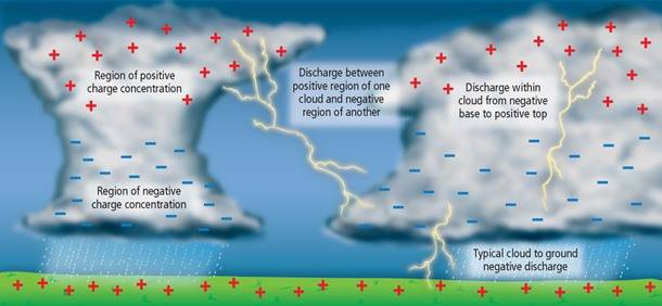

OK, let focus on heavy currents only, during the thunderstorm, there are many positive charges on the ground, please see following images, could this charges magnetize the steel within concrete? the positive charges can easily get through concrete with no problem.
Do you have any suggestions?
Thanks everyone very much for any suggestions
No.
Incorrect.
A lighting strike could in theory magnetize steel however.
EDIT: Make sure you read and understood that link I gave you, it will help you tremendously.
