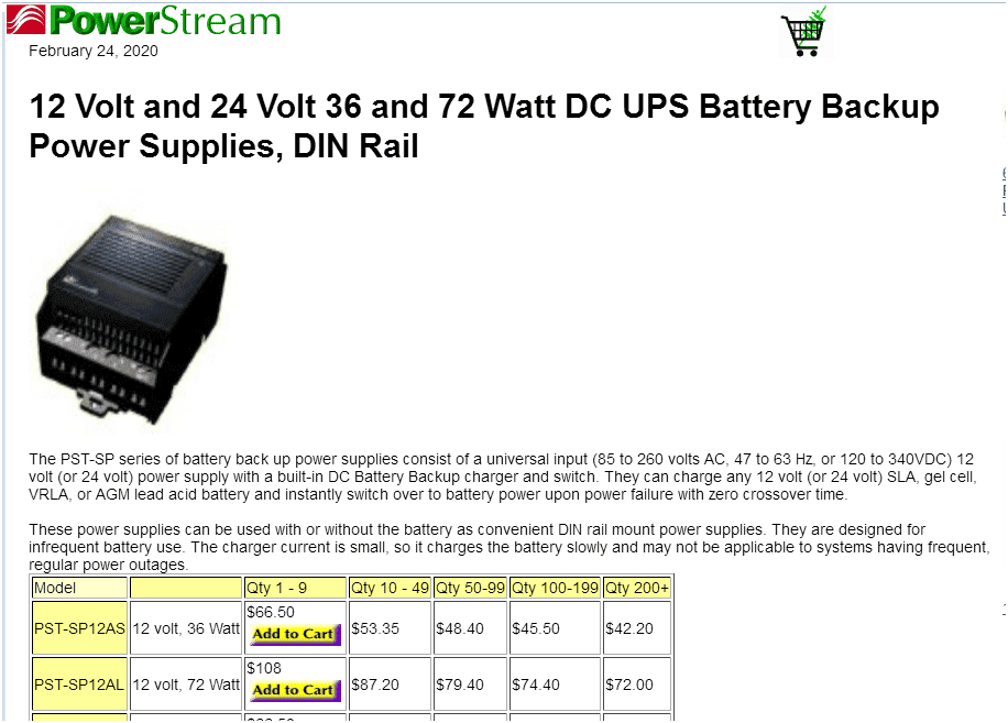

When it comes to battery powered projects (especially if you are not a battery and power supply expert), it's best to use as much off-the-shelf stuff as possible.
Consider using this DC UPS controller and maybe a good-size lead acid car battery:
https://www.powerstream.com/12V-backup.htm

LOL, yeah, I own a lot of stock in PowerStream (well, and Google, which helped me find the product).
We are trying to help you to avoid setting your house on fire, among other things.
