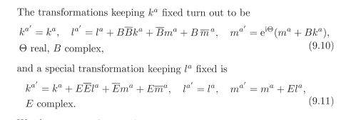

Currently, I meet with the so-called null rotation in my study. I cannot understand why it has a mathematical form like that? Is there anyone familiar with this? Can anyone give a lucid explanation of it or provide steps to derive it.
See the image above on the null transformation (in Newman-Penrose Formalism)
Thanks.
These are all the transformations that preserve the orthonormality relations among k, ℓ, m. For example, ask yourself, what tetrad rotation preserves ℓ? The most general form is
ℓ → ℓ
m → m + α k + β ℓ
k → k + γ ℓ + δ m + ε m*
and try to determine the coefficients:
k = k* ⇒ δ = ε*
ℓ·m = 0 ⇒ α = 0
k·m = 0 ⇒ β - ε
k·k = 0 ⇒ γ - ε ε*
