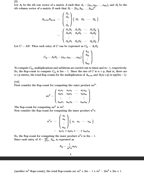

So for this one A=uv^T would it be ok to give this answer? View attachment 1998
But it only gives the floating operations for (uv^T) does it change if we have (uv^T)x ? In fact I need to show how many FLOPs are needed to compute (uvT)x and u(vTx) taking into account brakets... How does that change the calculation I have attached?
  • Handwritten-style notes deriving flop counts: matrix product entries, outer product uv^T costing m^2 flops, inner product u^Tv costing 2m-1 flops, and a total of 2m^2+2m-1+m^2 = 2m^2+2m+1.

Well, yes, any time you compute something else you're going to have more operations.
So now you have an mxm matrix times an mx1 vector. How many operations? Can you count them?

So if we have MxM and Mx1 then will it be just M^3? But about the brackets does that add anything to the FLOPs?
What about the other one is it just (2M-1)* M ?
To calculate the product of an mxm matrix with an mx1 vector, we need to do the following:
Take the inner product of each row of the matrix with the vector. We need to do this m times, so the total flops will be:
m*(whatever it takes to do an inner product of two m-vectors).
To take the inner product, we need to form m terms of a sum (the product of each row-entry by each entry of the m-vector (mx1 matrix)), and then sum them.(which will result in m-1 additional flops).
You do the math.

So for (uv^T)x I found that for uv^T part we are doing M*M operations then we doing matrix times vector which gave me 2m^2-M. So now do I just add M*M + 2m^2-M? Which will result M^3-M is that correct?
I also got 2m-1 + m which is 3m-1 Flops for u(v^Tx) is this correct as well?

$m \times m + 2m^2-m = 3m^2 - m$
As you can see, this is different from $m^3-m$.
This is correct.
It would appear this is way cheaper to evaluate! ;)

Oh yes, thanks you I just added it incorrectly but rest of it is really useful and thanks again.
