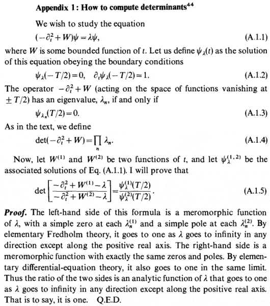

Hi,
I'm trying to prove the theorem found in the following scan of Coleman's Aspects of Symmetry.
So far, I have managed to show that the functions on both sides have simple zeros/poles, but I fail to see why they are meromorphic functions, and the steps that lead to their asymptotic behavior.
any help is greatly appreciated!

oh, and any hints or references on how to prove the formula using the zeta-function method would be helpful!
i have found a proof that the quotient of solutions to the homogeneous equations has 1 as its asymptotic limit.
It remains to prove the same asymptotic behavior for the l.h.s. and that boths sides are meromorphic functions!
please help! (it's kind of urgent :cry: )
Curious how to show that the RHS has simple zeros at the eigenvalues. By definition, the functions are zero when [tex]\lambda = \lambda_n[/tex], but not sure how this is a simple zero.
In any case, if they have simple zeros and poles, then it is easy to see that it is meromorphic.

Hmm, can you tell me exactly why the functions are meromorphic? my knowledge of complex analysis has deteriorated somewhat.
Your argumentation suggests to switch the limits, the one of the infinite product and the lambda-->infinity. I don't think this is allowed in general.
I have attached a proof that the r.h.s. has only simple zeros/poles, hope it's correct.
Thanks for your help!
You agree that the LHS function is a ratio of two polynomials? Then it only has isolated poles, one for every eigenvalue in the denominator. So it is holomorphic everywhere except for at those poles, and that is the definition of meromorphic. Unfortunately you need to assume some things about the eigenvalues here (probably due to the compactness of the domain, the eigenvalues are discrete), but that's as close as you can get to a proof.
Regarding the order of the limits. Yes, this is true. However, for the product even to be defined, you'll need some sort of regularization scheme (e.g., Zeta function), and you normally choose the regularization scheme so that it has certain nice properties. Multiplicative associativity of the determinant is usually lost, but I think the limit is still ok.
I couldn't see how the proof shows that the zeros are simple, and not something like [tex]e^{-\frac{1}{\lambda}}[/tex].
hmm, I see no problem with the proof. I have shown that the first derivative cannot vanish at the zero points. that should be enough, even for the example you have provided.
Sorry, I should have said that I assume the eigenvalues to be discrete, positive and that there are no limit points.
