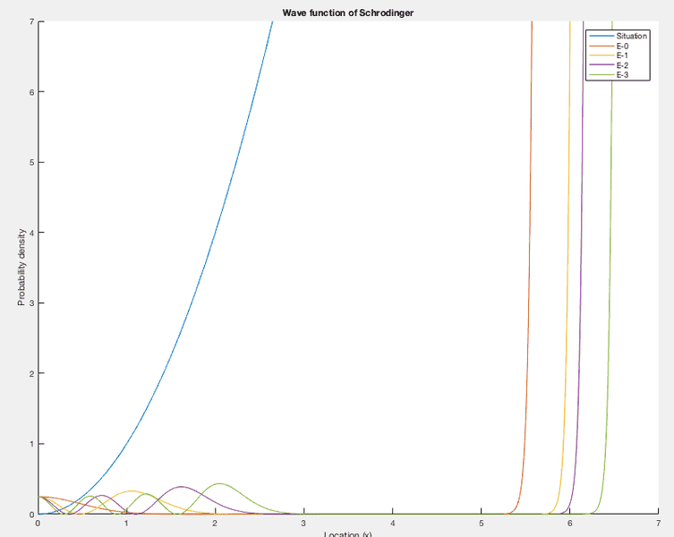

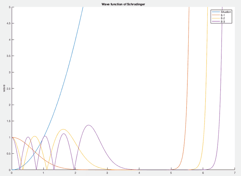

All this together results in the following graph
massfactor = 5;
C = 1;
wave = 1;
slope = 0;
The blue line represents the situation, x^2.
The orange one is the first energy state, the yellow one the second and the purple one the third (there are more), with the corresponding energy values of
E-1 = 0.4471758673234
E-2 = 4.0247949984073
E-3 = 7.6024556510729
I haven't got the slightest idea if this is correct, but hell, it seems okay?
(That's what my teacher said as well.)

First of all, you did a great job on yourself already. This is all very non-trivial stuff. What you discovered here is an algorithm to find the eigenfunctions for the Hamilton operator, known in the "computational physics" literature as the Fox-Goodwin or Numerov algorithm.
The math behind it is pretty tough to explain at the high-school level, but there is a huge mathematical theory behind it, which was developed in the early 20th century by Hilbert and many other mathematicians (like Fredholm) who thought about such eigenvalue problems of linear differential operators or integral operators on funcions a lot. Schrödinger just had to pick up these methods from the famous textbook on mathematical methods in physics by Courant and Hilbert when he developed his version of quantum theory "as a eigenvalue problem" ("wave mechanics"). The yellow one is that of ##E_2## and the purple one is that of ##E_4##. So there should be energy eigenvalues ##E_1## and ##E_3## between these.
You can tune your algorithm to find these eigenvalues and eigenfunctions by counting the "nodes" (i.e., the zeroes) of the wave function. If you look for ##E_1## you choose a trial value and check whether your wave function has exactly one node. If it has no node, the value of ##E## must be larger if it has more than one it must be smaller. In this way you can find these states and eigenvalues. Of course, the exact value of ##E_n## must be such that in addition to the correct number of ##n## nodes the wave function must also go to 0 at infinity as you've figured already out.
For the harmonic oscillator the Hamiltonian has only discrete eigenvalues given by ##E_n=\hbar \omega (n+1/2)## with ##n \in \mathbb{N}_0=\{0,1,\ldots \}##. As you have realized with your numerics the eigenvalues are those values for ##E## where the wave function goes to zero at infinity, and it must do so, because the wave function must be square integrable, i.e., the integral
$$\int_{-\infty}^{\infty} \mathrm{d} x |\psi(x)|^2$$
must exist, having a finite value. If you normalize the wave function such that this integral is 1, ##|\psi(x)|^2## is the probability density for finding the particle at position ##x##.
Further the mathematics tells you that the eigenfunction for the eigenvalue ##E_n## has ##n## zeroes. So from your plot it's clear that indeed the orange curve is (a good approximation of) the ground state for ##E_0=\hbar \omega/2##.

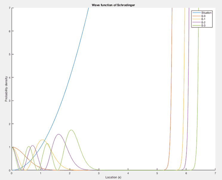

The current graph looks like this;
With
##E_0 = 0.4471758673234##
##E_1 = 2.2359736473542##
##E_2 = 4.0247949984073##
##E_3 = 5.8136234137805##
It seems okay, right?

Now, I wonder why all curves seem to have ##|\psi(0)|^2=1## for all your wave functions. Since the potential is symmetric under reflections, i.e, ##V(x)=V(-x)## the wave functions should be even/odd for the even and odd ##n##.
I understand why you ask that.
It correlates to the start value of ##wave## (see my earliest code), but not directly.
The previous screenshot is with a start value for ##wave## set to ##1##.
For example, if the start value of ##wave## is set to ##0.5##, it results in this graph, starting at exactly ##0.25##. (https://s11.postimg.org/spvrrsamr/Wave_function.png)
Seemingly it only scales it up and down?
I am not entirely sure what to set for the start value of ##wave##.
I would like to ask you, (1) what is the usual measurement of the probability density?
0% to 100%?
Also, (2) how come that for the higher energy values, the maximum probability density is higher than the maximum probability density for ##E_0##?

The Hamiltonian is invariant under spatial reflections, i.e., under the transformation ##x \rightarrow -x##. That's why the eigenfunctions of energy are either even or odd functions, i.e., ##\psi(x)=\psi(-x)## (even) or ##\psi(x)=-\psi(-x)## (odd). It turns out that ##\psi_n(x)=(-1)^n \psi_n(-x)## for the harmonic oscillator. For the odd function you have to choose ##\psi(0)=0## and then you can choose any value for ##\psi(h)## (where ##h## is the stepsize of your numerics). For the even function you must have ##\psi(0)\neq 0## arbitrary. Since further ##\psi(-h)=\psi(h)## you can resolve the recursion of the Fox-Goodwin-Numerov algorithm to choose ##\psi(h)##. See, e.g.,
http://www.iiserpune.ac.in/~pghosh/phy453/numerov.pdf
for details.
To give probabilities the wave function should be normalized to 1, i.e.,
$$\int_{-\infty}^{\infty} |\psi(x)|^2=1.$$
Of course, the probability to be in some finite interval is between 0 and 1, but the density can take any value!
