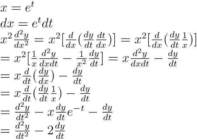

[tex]x=exp(t)[/tex]
Prove that [tex]x^2\frac{d^2}{dx^2}=(\frac{d}{dt})(\frac{d}{dt}-1)[/tex]
Let a tested function y

cks said:
It's an operator w.r.t x and we can find another equivalent operator that is w.r.t t
O damn I suck :( Idiocy conceded =]

x and t aren't independent. You can't just interchange the order of derivatives!
Try computing
[tex]\frac{d}{dx} \frac{d}{dt} x[/tex]
and
[tex]\frac{d}{dt} \frac{d}{dx} x[/tex]
for a concrete example!
Remember, cks, that x and t are related by an EQUATION; they are not independent variables.
ooo, I see. Thank you very much.
