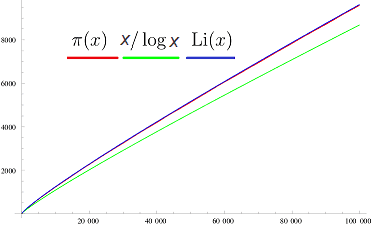

Wikipedia has a nice image about the difference between the curves:
