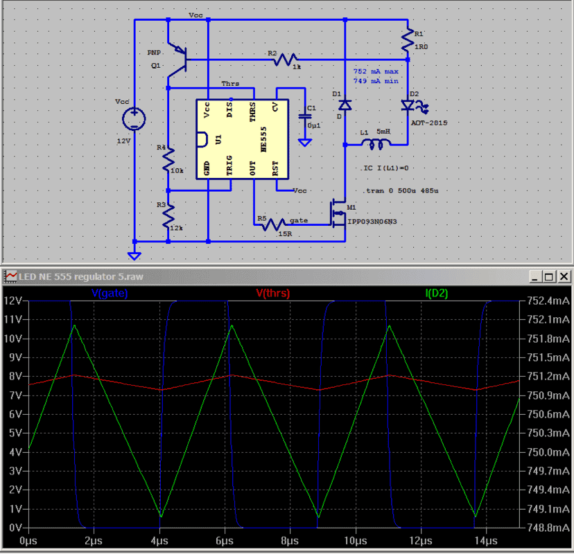

Here is a circuit that efficiently regulates LED brightness without producing an on/off strobe. It works as a switching regulator, but it regulates the current through D2, the LED, not the voltage.
How it works; Continuous current through the LED, L1 and R1 flows either through N-channel mosfet M1, or through the flyback diode D1.
The LED current is set by the value of R1. As LED current rises, voltage across R1 increases, PNP Q1 conducts more, which raises the voltage Thrs, which turns of the NE555 output and so M1. The flywheel diode then conducts while L1 current reduces, until the Trig voltage falls, turning the NE555 and M1 back on.
When Trig and Thrs are tied together, the voltage ramps between 1/3 and 2/3 of Vcc. Here R3 and R4 reduce that to only about 700mV, which reduces the LED ripple current to about 3 mA.
R5 should be closer to 47R to limit gate current from the NE555 to about 200mA. Vcc noise on CV is reduced by C1.

Don't think that will work if he has 12V LED strips which are normally made from groups of 3 LEDs and dropping resistors?
It will work as a current regulator to a 12V LED strip.
The resistors will balance the current to the groups of LEDs.
To get full brightness from a 12V strip you will need to raise the Vcc supply voltage to 15V.
