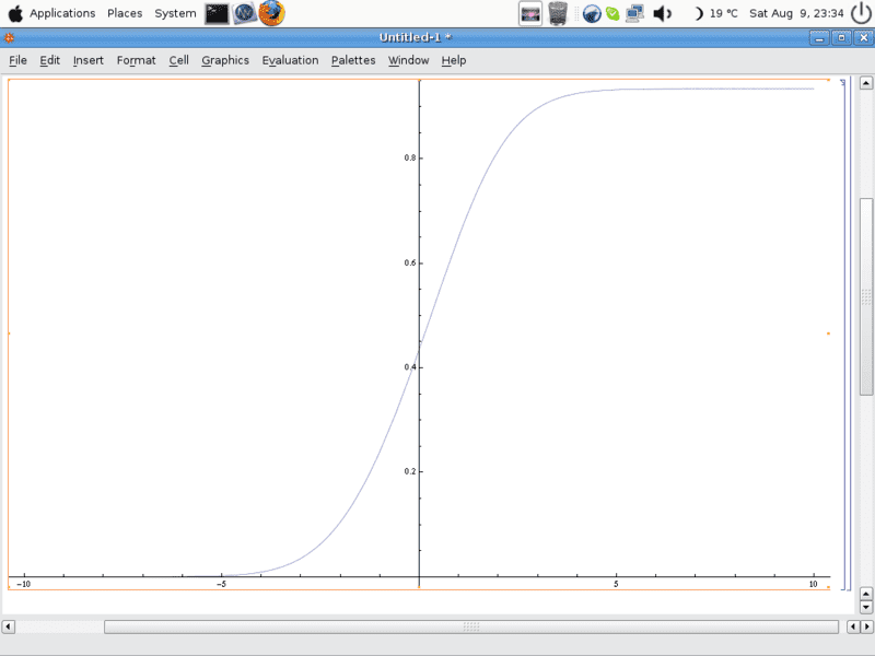

As you already know this task is not so simple to solve because of multi-integration. First it is very useful and not so painful see whether first integral exists: :smile:
[tex]\Theta(u,x,v,y,w)=\int_{-\infty}^{w} f(u,x,v,y,w,z) dz = \frac{1}{2}e^{-\frac{x^2}{2}-\frac{y^3}{4}}\;\sqrt{\pi} \left(1+Erf(\frac{w}{\sqrt{6}}) \right) + <br /> \frac{1}{4\pi}\; e^{-x^2+xy-\frac{y^2}{2}} \left(1+Erf(\frac{w-y}{\sqrt{2}}) \right)[/tex]
Integrals would exist if [tex]u,v,w \in (-\infty,0)[/tex] otherwise integrals diverge !
You can see that if above integral split on two integrals
[tex]\int_{-\infty}^{0} \Theta(u,x,v,y,w)\; dw = 0.586571 + O(10^{-6})[/tex]
[tex]\int_{0}^{\infty} \Theta(u,x,v,y,w)\; dw \rightarrow \bf{\infty}[/tex]
Trick how to see whether this exist to plot it. Put [tex]x=y=1[/tex] as you already know [tex]x \in (-\infty,\infty)[/tex] and [tex]y \in (-\infty,\infty)[/tex]. I made also graph so see what is the shape of function and is attached to this answer.
If you don't understand just send me email and I will try to explain.
Enjoy :smile:

Sorry I forgot to mention numerical solution [tex]= 0.586571 + ...[/tex] comes form [tex]x=y=1[/tex]. It is only to see that first has numerical solution other diverge.

Thankyou very much for your efforts!
One important aspect of this integral is this: It belongs to a class of integrals which apparently diverge, but not in the real sense.
For example define two functions
[tex]f(x)\ =\ x^2 + e^{-x^2} \[/tex] and
[tex]g(x)\ =\ x^2 + e^{-2 x^2} \[/tex]
then individually the two integrals:
[tex]\int_{-\infty}^\infty f(x)\ dx[/tex] and [tex]\int_{-\infty}^\infty g(x)\ dx[/tex] diverge but [tex]\int_{-\infty}^\infty (f(x)-g(x))\ dx = \sqrt{\pi} - \sqrt{\frac{\pi}{2}}[/tex]
Similarly, the six-dimensional integral has another 3 dimension integral in the denominator (which I have not posted or mentioned earlier) such that the ratio is a finite number, in a limiting sense. I know this is a very very complicated integral, which naturally arises while solving problems in financial mathematics, so what I am interested in is, a numerical method to handle such integrals involving limiting case:
[tex]\lim_{a \rightarrow \infty} \left(\frac{\int_{-a}^a \int_{-a}^u \int_{-a}^a \int_{-a}^v \int_{-a}^a \int_{-a}^w \nu(x,y,z) \ dw\ dz\ dv\ dy\ dx\ du}{\int_{-a}^a \int_{-a}^a \int_{-a}^a \delta(x,y,z) \ dz\ dy\ dx} \right)[/tex]
Kind regards and thanks to one and all.
hpriye
No problem.
I would solved it by Simpsons method, has good accuracy at low number of steps. Don't forget functions are very quick :smile:
