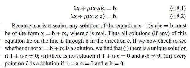

I have some doubts about the solution to ## x + (x \cdot a)c = b ## according to the first attachment, (Alan F. Beardon, Algebra and geometry)? λ = 1 and μ =1
He says that we should view the above equation as a line ## x + t*c = b## then substitute this x back into ## x + (x \cdot a)c = b ## but t also has x in it? As ## x + t*c = b## comes from ## x + (x \cdot a)c = b ## how can we put it back into the original equation as above?
Next, I made the substitution in the second attachment. Please explain why t is all the real numbers as solution when ## a \cdot b = 0 ## AND ## 1 + a \cdot c = 0 ##? ##\frac{0}{0}## is undefined right? is that why t can be any value?

PcumP_Ravenclaw said:
x+(xa)c=b
So scalar multiply this equation with a. This will give you a solution for x⋅a and then for x.
## x \cdot a +(x \cdot a)(c \cdot a) = (b \cdot a)##
factorising ## x \cdot a ## gives ## (x \cdot a)(1 + (c \cdot a)) = (b \cdot a) ##
## (x \cdot a) = \frac{(b \cdot a)}{(1 + (c \cdot a))} ##
say RHS = the scalar m then
##x_1 a_1 + x_2 a_2 + x_3 a_3 = m## now how to find x1, x2 & x3?
You have just computed x⋅a. Your original equation says x+(x⋅a)c=b. I assume that b and c are given. Solve for x
