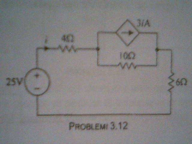

1. Homework Statement
For the first one :We have the circuit in the figure.We have to find i.If its not clear,the current on the right top says 3i,and the one in the left just i.

For the first one :I don't really know what to do about this one.The current across 10 Ohm is i1,now I write the KCL and I have i=3i+i1 here I have that i1=-2i.I find the voltage across 10 Ohm and it is -20 V.I am thinking about finding the resistance across 3i,so I can find the whole resistance of the whole circuit and then 25/ (Equivalent resistance) but the resistance is negative :/

First of all, terminology:
Voltage is dropped across a resistor or other circuit element.
Current passes through a resistor or other circuit element.​
You have a current of " i " flowing through the branch with the 25V voltage source and 6Ω and 4 Ω resistors .
You have a current of 3i through the branch which has only the current source. That's the diamond shaped object with the arrow in it.
Use KCL to find the current through the 10 Ω resistor. (This will be in terms of " i " at this point.)
Then use KVL for the appropriate loop to give you an equation with only the variable, i .

The final loop equation : -25 V - 4i -20i -6i=0 ..
I don't agree with that.
The current through the 10Ω resistor is 2i , pointing to the left.
If you take the loop with the voltage source and the two resistors along with the 10Ω resistor, in a clockwise direction, the source gives a positive contribution, so does the voltage across the 10 Ω resistor (The current through the 10 Ω resistor is opposite to the direction taken around the loop.)
Please try again. Give the loop equation and give your numerical result for the current rather than simple stating, "I figured it out".
