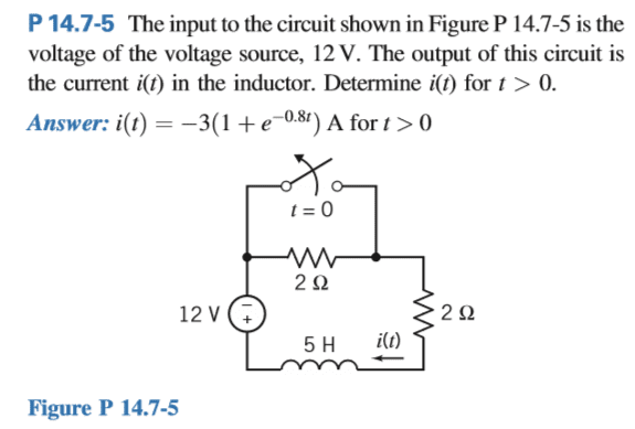

Circuit schematic with a 12 V voltage source, a switch marked t = 0, a 2 Ω resistor, a 5 H inductor carrying current i(t), and another 2 Ω resistor, next to the problem statement and answer i(t) = −3(1 + e^−0.8t) A for t > 0.

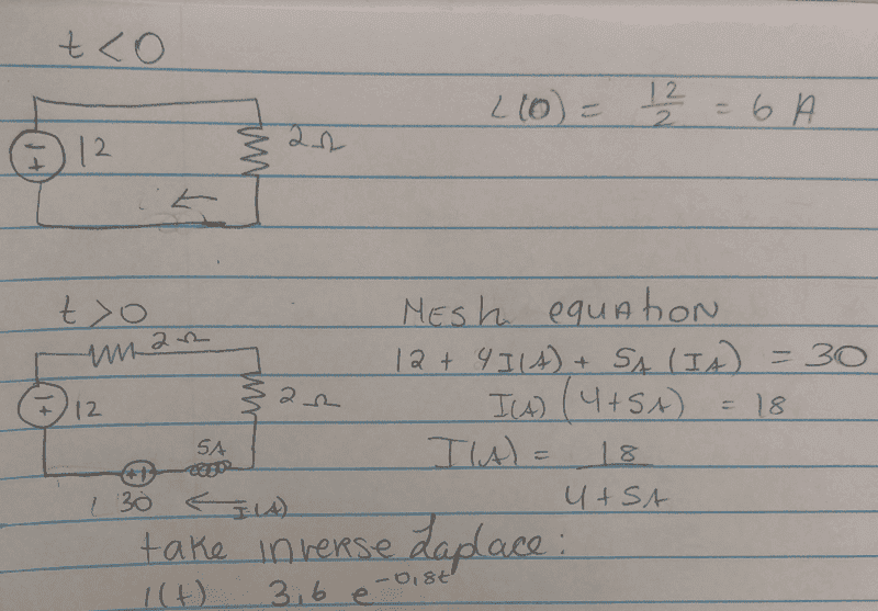

Handwritten circuit analysis on lined paper: a t<0 circuit with a 12 V source and 2 ohm resistor giving I(0) = 12/2 = 6 A, and a t>0 circuit with a 2 ohm resistor, 5 H inductor and 30 V source, with mesh equation 12 + 4I(s) + 5s I(s) = 30, I(s)(4+5s) = 18, I(s) = 18/(4+5s), and inverse Laplace result i(t) = 3.6 e^(-0.8t).
As you can see, the answer is given in the problem. I have the 0.8t par right but somewhere along the way I messed up. I'm not really to sure about how to solve these types of problems using Laplace. Is there a general procedure that I should be following that I am not?
The Laplace transform of a DC source is V/s. Essentially it's modeled as a step function, "turning on" at time t = 0. So your 12 V source should be 12/s.
The voltage that represents the stored energy due to the initial current (your 30 V supply) needs to have its polarity reflect the actual direction of that initial current.
Otherwise you seem to be doing okay.
