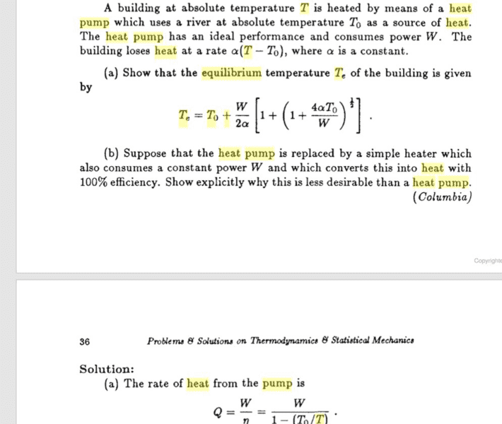

Ashley1nOnly
132
Scanned textbook page with a problem statement about a building heated by a heat pump, followed by the equilibrium temperature formula Te = T0 + (W/2α)[1 + (1 + 4αT0/W)^(1/2)] and the start of a solution showing Q = W/η = W/(1 − T0/T).

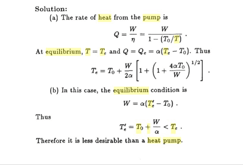

Typed solution to a heat pump problem: Q = W/η = W/(1 − (T0/T)), equilibrium Te = T0 + (W/2α)[1 + (1 + 4αT0/W)^(1/2)], and T'e = T0 + W/α < Te.
Handwritten algebra on lined paper deriving an equilibrium temperature Te from heat flow equations involving Q, w, alpha, Tc and To, ending with a square-root expression for Te.
I'm trying to solve this problem but I can't get the Te by itself. Does anyone have any answers as to a direction I should take?

Are you familiar with how to find the roots of a polynomial of degree 2?
I solved it with your help. I didn't even think about doing it that way. Thanks
