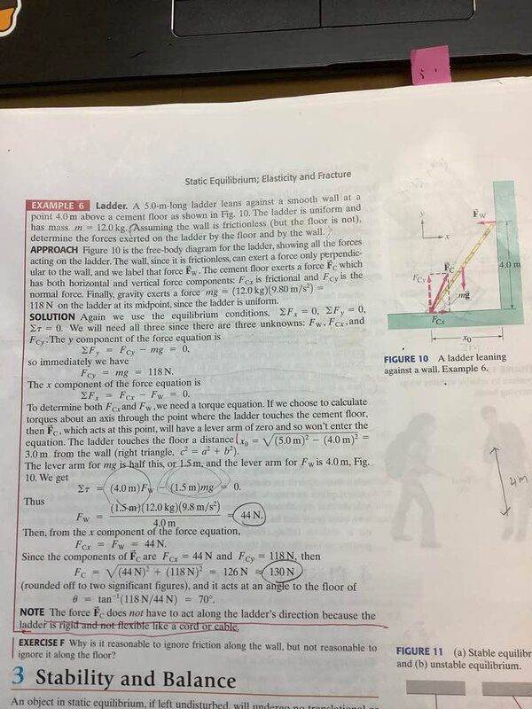

A 5m long ladder leans against a smooth wall at a point 4m above a cement floor as shown in the figure (image below). The ladder is uniform and has mass m = 12kg. Assuming the wall is frictionless (but the floor is not), determine the forces exerted on the ladder by the floor and by the wall.

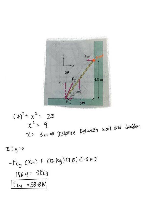

1. The following is my attempt to solve Fcy using the fact that the addition of torque = 0. I considered force mg and Fcy and their lever arms to set up the equilibrium. But this method seems not to work? Why?
2.At the bottom of the question, it reads, "Why is it reasonable to ignore friction along the wall, but not reasonable to ignore it along the floor?" What would be an answer to this problem?
I presume you are taking torques about the point of contact with the wall in your equation. But you haven't included the torque of ##\vec{F}_{C,x}## in your equation (N.B. you also missed an "##=0##" :wink:).
Alternatively, @Sunwoo Bae is taking moments about the base of the wall, in which case it is FW that is missing.

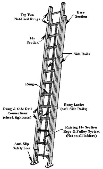

Since force of friction depends on the normal force, where will you see the biggest normal (to ground or wal) force, especially when a person is climbing that ladder and the angle of lean is moderated?
Hint: Most extension ladders have rubber pads and spikes at bottom end and nothing at top end.
