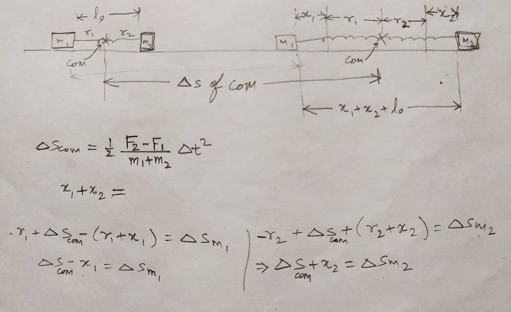

If m1 moves x1 to the left and m2 moves x2 to the right then that shifts the "mass moment" m2 x2 - m1 x1 to the right, so (m1+m2)Δs = m2 x2 - m1 x1, where Δs is positive to the right.NTesla said:@haruspex ,
I've tried to find a relation between CoM's displacement and ##x_1## and ##x_2##, but it appears more difficult than I assumed it to be. Here's my work: View attachment 273350
I am not able to figure out the relation. let me know how to proceed.

Not sure if that's what you meant. There's no problem explaining that; do you mean, how do we use it?NTesla said:@haruspex, Thank you so much. That was very helpful.
Just one question: If we do not resort to center of mass FoR, and work solely in Ground FoR, then how can we explain that the maximum elongation will happen when both the masses have same velocity as that of velocity of com ?
Isn't it the same as saying the two masses have the same velocity?

@haruspex,
When working in CoM FoR, both the masses will seem to be moving in opposite direction and maximum extension in spring will happen when velocity of both the masses is equal to zero at the same instant.
However, when working in Ground FoR, the bodies might seem to be moving in same direction, but maximum extension of spring will happen when both the masses have same speed in same direction. Will it be right to say so.? If yes, then is there an intuitive way to explain that this is the only way possible for string to have maximum elongation in Ground FoR ?

If the two masses have different velocities in the ground frame then they are either getting closer or further apart. If closer, they must have been further apart earlier; if further apart, they will be at max separation later. So when at max, the relative velocity must be zero.NTesla said:@haruspex,
