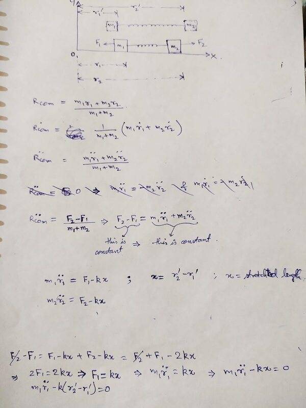

NTesla
276
28
Two blocks of masses m1 and m2 are connected by a spring of spring constant k. The block of mass m1 is pulled by a constant force F1 and the other block is pulled by a constant force F2 in the direction opposite to that of F1. Find the maximum elongation that the spring will suffer.
Newton's laws of motion
I have solved this question in Center of mass frame of reference, by using energy conservation. However, I'm not able to write any equation when I'm trying to solve it in Ground frame of reference. Can somebody please let me know how to begin in Ground FoR.

I thought once extended to the maximum the spring becomes as the rod so the two body are regarded as one body.
[tex]F_1-T=m_1 a_1[/tex]
[tex]T-F_2=m_2 a_2[/tex]
and at last
[tex]a_1=a_2=\frac{F_1-F_2}{m_1+m_2}[/tex]
I am interested to know your result of oscillation.

I've tried to attempt this question from Ground frame of reference, but not able to move towards solution. Here's my attempt:

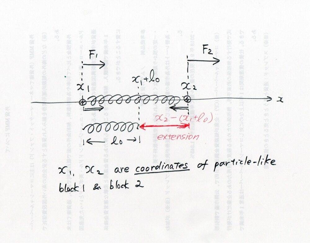

The spring gets extented by ##x_2(t)-x_1(t)-l_0## from its natural length.
NTesla said:
But how much the mass m1 has moved solely due to F1 or how much the mass m2 moved solely due to F2 is not given.
Sum of external force and spring force keep applying on the blocks. There happens no such a thing as "move solely due to one force".
NTesla said:
Moreover, when viewed from Ground Frame of reference, the mass m1 has moved NOT just by x1, but by (x1+the distance moved by CoM). Likewise for m2.
All the above ##x_1## and ##x_2## are coordinates mentioning the position of the particle like blocks in ground frame of reference. We do not have to care about "CoM distance moved" for our problem.

@anuttarasammyak: In the following equtions that you've written in post#4, please explain what have you considered ##x_1## and ##x_2## to be. My understanding is that ##x_1## and ##x_2## is the displacement of mass ##m_1## and ##m_2##. If it is so, then stretch of string at any point of time will be ##x_1+x_2##. Then, why have you written the following equations in post#4, considering ##x_2-x_1-l_0## as the stretch of the string:
[tex]m_1 \ddot{x_1}=k(x_2-x_1-l_0)+F_1[/tex]
[tex]m_2 \ddot{x_2}=-k(x_2-x_1-l_0)+F_2[/tex]

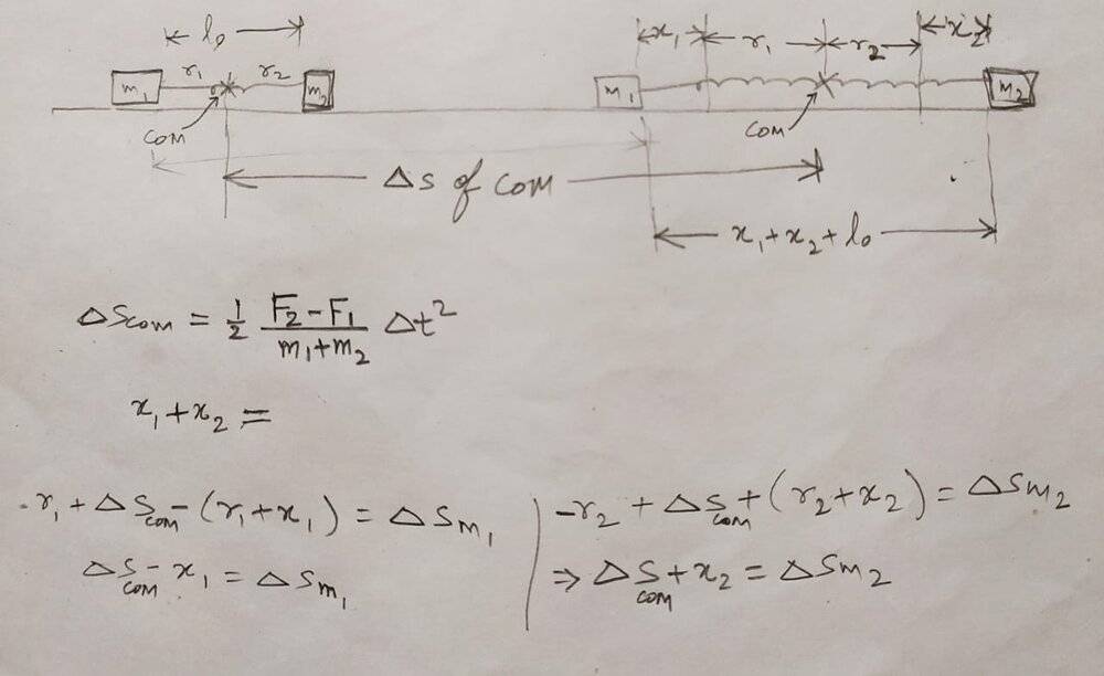

@haruspex,
I've written the momentum equation:
$$\left ( F_2-F_1 \right)\Delta t=\left ( m_1+m_2 \right )v_{com}=m_1v_1+m_2v_2$$
and Energy equation :
$$F_1x_1+F_2x_2=\frac{1}{2}m_1v_1^{2}+\frac{1}{2}m_2v_2^{2}+\frac{1}{2}k\left ( x_1+x_2 \right )^{2}$$
But if I write another equation involving displacement and time, like following:
$$\Delta s=\frac{1}{2}\left ( \frac{F_2-F_1}{m_1+m_2} \right )\Delta t^2$$
then I'm including one more variable ##\Delta s##.
I am not able to write an equation involving displacement and time which doesn't involve a new variable. Where am I going wrong. Please help.
Hi.
Please find attached my configuration. I hope it will help you.

NTesla said:
then I'm including one more variable Δs.
That's the displacement of the mass centre. How does that relate to m1, m2, x1 and x2?
