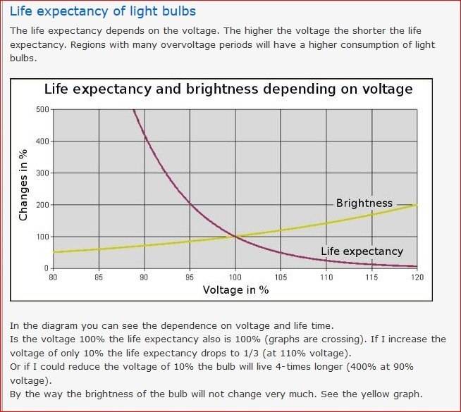

I assume you're on a 120 volt system. If you find a "Long Life " 130 volt bulb it'l last much much longer than will a 120 volt one.
http://www.frankshospitalworkshop.com/electronics/training_course_halogen_bulbs.html
a non-academic source but it conveys the point

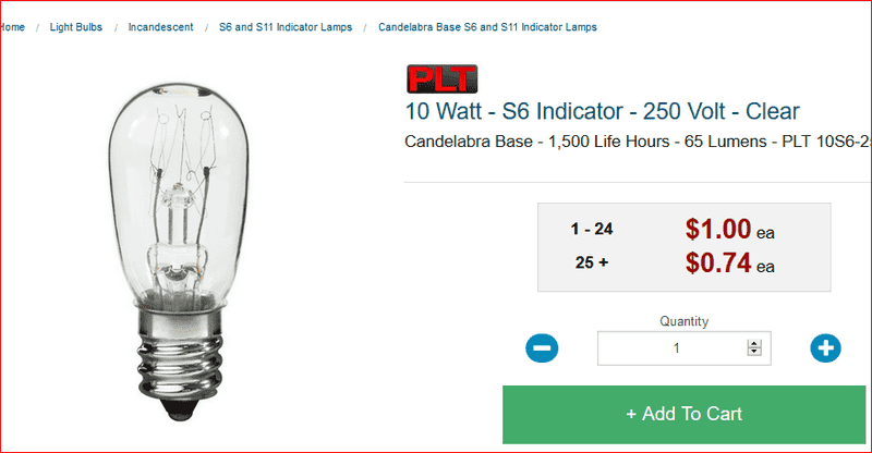

Now fine tune your solution - try a nightlight bulb in your socket preferably a 130 volt one ..
If you could find a 150 or 230 volt one so much the better, it'd last practically forever.
https://www.1000bulbs.com/product/77/IN-0010S06CC250.html

Look at industrial supply houses for 150 volt lamps. That S6 pictured is about the size of a night light bulb. A 150 volt one would last a VERY long time at 120 volts.
(150/120)^12.5 = 16X longer than a 120 volt bulb. It'll be a warm light lacking in blue and green though, and not very bright for its wattage.
