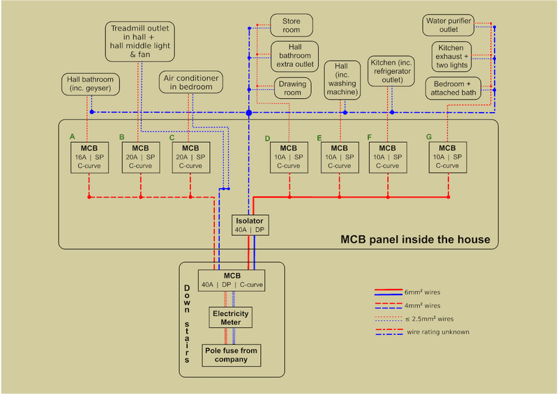

This is kind-of a sequel to my two other threads, but not exactly related to them.
We re-did a portion of our house wiring to accommodate a new 20A outlet. Also shelled out a few more bucks to replace the in-house fuses with MCBs. The circuit looks like this currently:
Note that the two pairs of wires from the downstairs MCB to the MCB panel inside the house have been newly installed and not existing lines.
Here's what happens: As you can see, the hall bathroom is connected to the ##4~\mathrm{mm}^2## wires separately through an SP MCB and do not pass through the isolator. However, if I switch off the isolator, the lights in the bathroom (including the geyser outlet) start blinking (dimly lit → off → dimly lit). We do not have a geyser; I verified the blinking in the geyser outlet with a 40W incandescent bulb. This line should remain unaffected by the isolator. If I switch off their MCB, they stop blinking.
On the other hand, if I switch off the MCB for the hall (the second MCB that connects to the isolator) with the isolator still turned off, the lights connected to that hall circuit start flickering at a low brightness (dimly lit → off → dimly lit).
Now I have called the electricians — the same guys who installed the new wires and the outlet — tomorrow, but would be grateful if anyone can make an educated guess on what is happening. Electricians here aren't exactly qualified (as in, they do not need a licence to work), so some opinion from the experienced people here is appreciated. I have a multimeter, so can do further tests as long as I don't have to open the MCB panel (can't do that because we don't have ladders).
I am also going to ask them to interchange the kitchen with the hall bathroom line, as the kitchen refrigerator outlet can handle 20A, and we do not have plans of installing a geyser in the near future.
Edit: labelled the MCBs
Something is crossed up somewhere. I hate to imagine. Isolation is your friend. What other breakers getting turned off affect this? I am curious what the voltage is when you have the incandescent bulb hooked at the geyser outlet and it blinks.

There are likely other possibilities, this is the one that comes to mind from your description.
ONE of the wires feeding the Hall Bathroom is not connected to the main incoming power. It is instead connected to something on the right hand side of the drawing.

Exactly because of such cases why it's advisable to have different circuits placed in different tubes/boxes while following the 'natural' topology based on physical/logical placements.
Something is just cross-wired there, I think.
To start with, having that 'Hall bathroom' on the left while having a 'Hall bathroom extra outlet' (was that installed later?) on the right is just asking for trouble and highly suspicious, IMO.

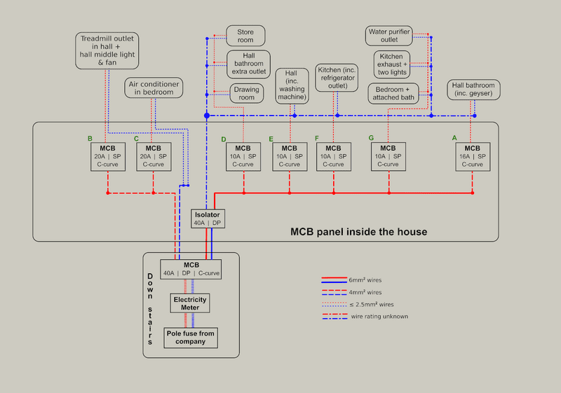

General note: I have updated the picture and labelled the MCBs to refer to them easily.
Tom.G said:
Also, what does the Isolator consist of? What is in it?
Just a DP switch that can handle upto 40A.
The extra outlet in the bathroom was indeed installed after the main house wiring was done. But before we shifted to the apartment. Not sure why they connected it to the drawing room and store room line; probably they thought that if we install a geyser of high capacity, the bathroom line will be drawing nearly ~16A, while there was no heavy load on the drawing room/store room line. How do I know it is connected to the drawing room/store room line? Switching off the MCB D switches off that outlet.

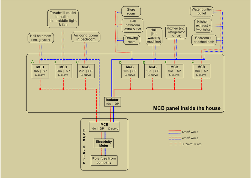

Here's what happened: In the past, before this re-wiring job, we had only one pair of 2.5mm2 wires coming up to the fuse panel from downstairs. The air conditioner was wired directly to the live wire coming from downstairs, and the rest of the house was connected via a DP MCB. There was no separate neutral from the air conditioner or the hall bathroom geyser. I was not aware that there were no separate neutral wires from the air conditioner or geyser outlet.
These guys installed two pairs of wires, as mentioned in the OP. But they joined the two neutrals at the isolator, making the new wiring diagram something like this:
So as soon as I switched off the isolator, neutral was disconnected from the entire house except the treadmill outlet, while three places still had the live switched on. This resulted in a "phase reversal" as they call it: for the entire house, the neutral line was now carrying the live. Which explains why I was seeing a 230V PD between earth and neutral after switching off the isolator. They are asking me why I am switching off the isolator. I mean, you installed it so that we can switch it off later, right? Their solution: turn off MCBs A to C first, then turn off the isolator.
I am frustrated at this point. Interchanging live and neutral in costly appliances is just the dumbest thing to do. And they were pretty much aware that this would happen. Just never felt it necessary to let me know.
In the USA ANY neutral would never be interrupted in a case like this. Only the hot. It sounds like you still have a path back to neutral in some way since you had an incandescent bulb lighting when it should not have been. Or at least a partial path. I would work on finding this.

Yes, true. We are going to re-wire things.
From what it seems (I tested yesterday a bit), the air conditioner and the treadmill outlets both have their live and neutral wires directly connected to the pair of 4mm2 wires. The bathroom and geyser section is the only one that is connected to the 4mm2 live, but uses the existing house wires as neutral, and hence, its neutral is connected to the isolator. The circuit is approximately like this:
To be honest, I am still not sure why live and neutral are getting interchanged when I switch off the isolator.
Anyway, what I have decided is to call the guys and ask them to connect the geyser live to the 6mm2 wires, so it will be in sync with the rest of the house. I'll also ask them to shift the geyser to a 10A MCB and the kitchen to a 16A MCB because we don't have a geyser and don't need to draw 16A from that section, while the kitchen section could definitely use another 10A for small kitchen appliances like toaster and mixer grinder (clarification: doesn't include microwave), along with the existing 6A-rated refrigerator. The kitchen wires are already 2.5mm2 wires, so it shouldn't be an issue to draw 16A.

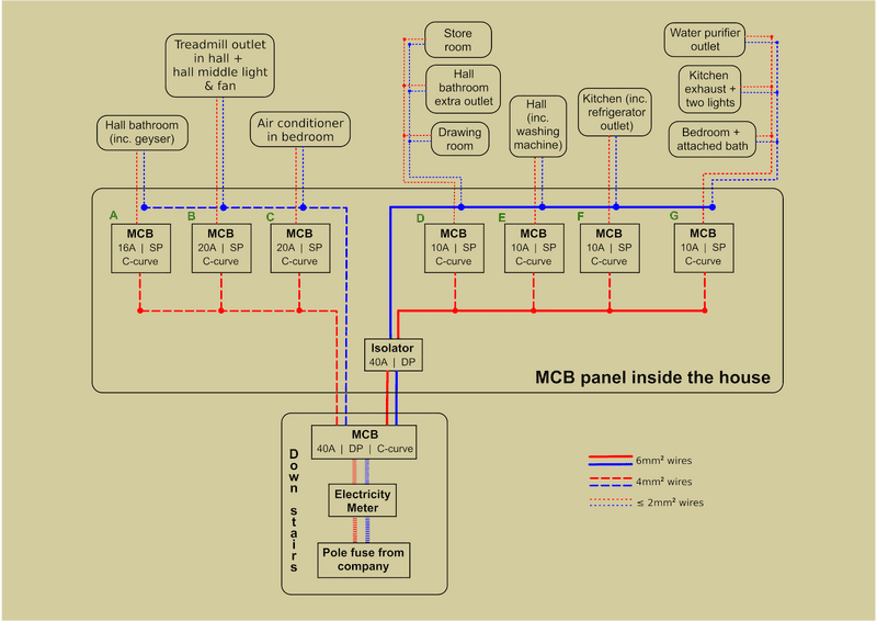

I was wondering if I could add a 15kVA servo stabilizer for the entire house.
Even though I live in a metropolitan city, we do have sudden voltage fluctuations, as well as constant low voltage in the summer due to every house running an air conditioner. Part of this happens because people use more load without obtaining a green signal from the company. I had to buy one rated 5kVA for my treadmill — the seller recommended it as the motor and motor controller are sensitive to fluctuations. And to be honest, this is precisely what I was looking for. The stabilizers that we have currently for the air conditioner and refrigerator are relay-based and have a single tap in the transformer. Which means that if supply goes down to 200V, it will output 220V. But if it goes down to 180 or 170V (which does happen once in a while), it will output 200 or 190V. Which is outside the range of rated voltage for appliances. They don't have any support for higher voltages, either; they just turn themselves off to save the appliance. A servo stabilizer gets rid of each of those issues. Buying separate servo stabilizers for each appliance makes no sense — these are costly, and if I can get one that serves the entire house, I will be happy to pay a bit more and get that.
I had a word with the servo stabilizer seller; he said that 10kVA supports up to 7.5kVA, so 15kVA should be enough for my entire house, including the current air conditioner and any future loads up to the sanctioned maximum load. The wiring is what I have to plan.
I was thinking of feeding the two 4mm2 and 6mm2 wires coming from the MCB downstairs directly to the servo stabilizer. Then separating the output into two parts. In this situation, I will not be able to separate the loads from the 4mm2 and 6mm2 wires.
Any better idea anyone? Or any advice regarding this idea of adding the stabilizer? I want a single solution for the entire house, if possible.
This setup has resolved the problem for now:
We have planned a few enhancements, but that will be in a few months.
Also, two 10kVA servo stabilizers seem to be a better idea than one 15kVA. Will cost a bit more, but mixing wires of different gauges is not an option, obviously. If each 10kVA can handle up to 7.5kVA (as per the dealer/manufacturer), then that's ≈ 33A at 230V RMS. Enough for each line. The 4mm2 anyway cannot handle > 24A.

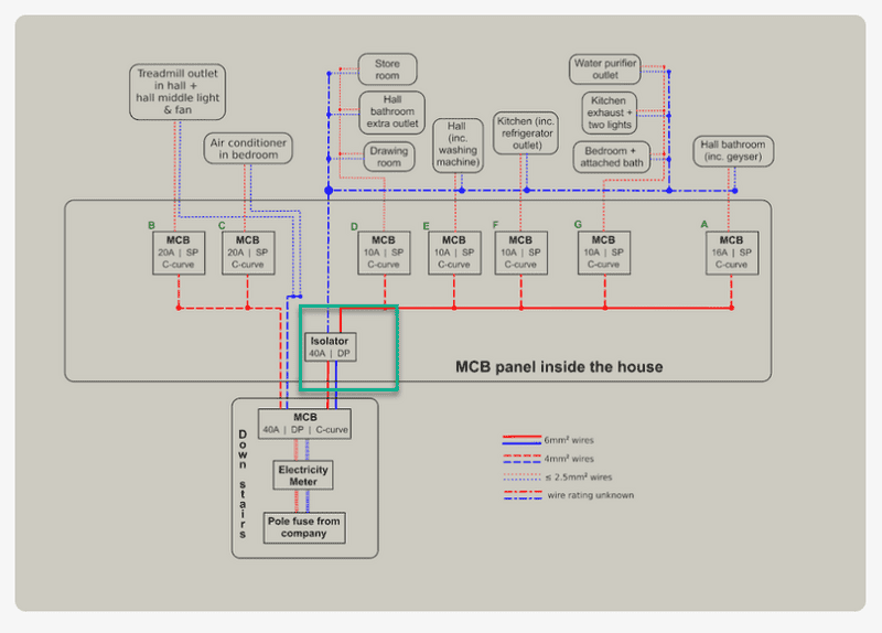

From my personal experience as an electrician, I can say the following. A decrease in lamp illumination is often associated with a neutral conductor breakage (or incomplete breakage). Fluorescent and LED lights may blink due to the presence of capacitors. It seems to me that using stabilizers will do nothing, since your circuit is in a state of disrepair. We need to check all outgoing lines. You must have an electrical wiring diagram. First of all, you need to check that all the wires are connected correctly according to the scheme. You need to make sure that the circuit breaker breaks the phase. Be sure to check the grounding. If everything is in order according to the scheme and with the grounding, you can check the outgoing lines as follows. Turn on all the devices and measure the voltage in the switchboard between the neutral of each outgoing line (after its automatic) and the phase. There must be a rated mains voltage. If the voltage is zero or very different from the rated voltage, it means an open circuit
In general, even in the diagram, it seems that after the insulator, the phase goes into neutral, and the neutral goes into phase. Please check the phasing

The issue was the hall bathroom line got its phase/live from the ##4~\mathrm{mm}^2## wire, but its neutral was connected to the ##6~\mathrm{mm}^2## wire because it was directly connected with the neutral from all the other rooms. So when the isolator was switched off, the neutral was cut off, but it still got the live. Moving its live to the ##6~\mathrm{mm}^2## solved the problem.

Ah yeah, that is an error in the diagram. Have to switch the input lines. Thanks for pointing out!
