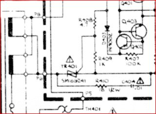

Hi Guys,

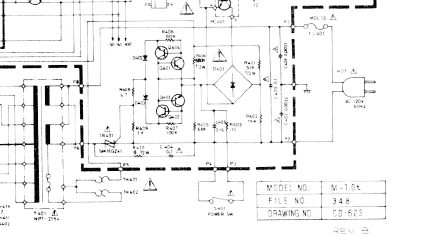

I am working on a Carver model M-1.0t stereo amp. There is no AC voltage to the input transformer primary.

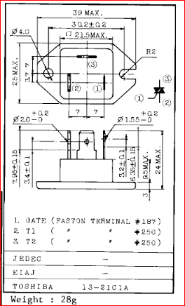

The AC input is controlled by a Bi-Directional Triode Thyristor. This is the data sheet.
http://www.datasheet.hk/view_online.php?id=1927120&file=0465\sm16gz41_6629879.pdf
This is the schematic.

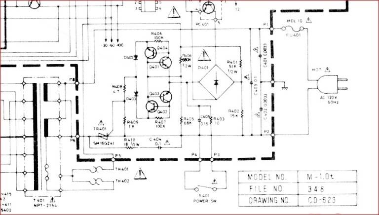

This is the full schematic.
http://bmamps.com/Schematics/Carver/Carver%20M-1.0t%20Service%20Manual.pdf
EDIT: a full schematic of improved clarity is available here.
Is there a way to test this device?

It is the power control and voltage regulator. It (via the TLP631 opto isolator) regulates the power supply. Not sure where I'd start measuring.
If the fuse is not blown, I'd suspect something wrong on the other side of the transformer.
The block diagram will be useful in tracking it down.

In circuit or out ?
Voltage across R409 tells you gate voltage.
No gate voltage no conduction. About two diode drops will usually turn one on but I've seen them as high as 4 volts.
So you're looking for AC of almost a volt across R409 .
Can you read voltage across the thyristor itself ?

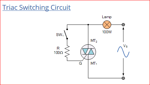

Out of circuit test
put it in series with a 100 watt lightbulb
When gate voltage exceeds about a volt, voltage across thyristor should collapse to near zero and the lamp illuminate.
here's a tutorial
http://www.electronics-tutorials.ws/power/triac.html

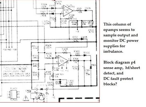

I've had a look at the circuit, briefly, there is is useful block diagram also, this part is "AC control"

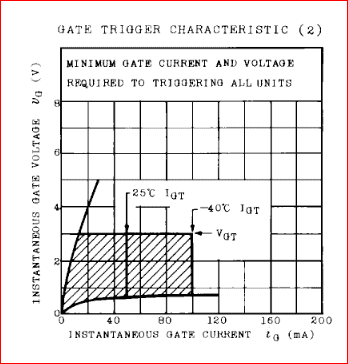

The data sheet for the device indicates a max gate voltage of 10 volts and I have no idea what the "normal" gate voltage should be. Got some reading to do as I do not understand this device and it's use.

I'd use that test ckt in post 6, use your 2 channel 'scope to observe gate voltage directly
both channels on 5 volts /div
vertical display A minus B
A to gate, B to MT1
I'm used to seeing around a volt on thyristor gates
in my control rod drive system the SCR's were nearly all between 1 and 2 volts
three outliers , 0.5V, 4V and 5V ran fine for decades
a very few volts is typical
see this datasheet Google picked at random for me, it's a small 8amp triac in TO220
http://www.nxp.com/documents/data_sheet/BT137_SERIES.pdf
try increasingly larger resistors in series with gate and you'll see turn-on delayed to later in the cycle.

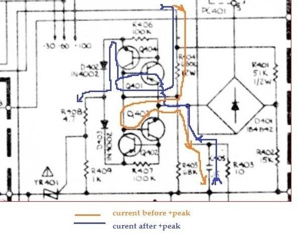

I do understand how a triac regulates voltage by "cutting" the sinus or enabling only one half of each half period through etc.
the thing is why i said what I said let's look at the schematic , the transformer has two primaries in parallel with the mains , each one has the triac in series , now suppose what you say is true and the transformer is designed such that it outputs its intended voltage levels only when the triac controls the input in the primary , now suppose that triac fails short as semiconductors tend to do very often when they fail, now you have full mains ac across that transformer primary , now it would be stupid to make that transformer that if this happens either the output voltage at secondary goes above the limits and toasts the whole amp (80's semiconductors were not as rugged as they are now) and or the transformer itself fries.
also they might have just put the triac on the secondary side , it would then be under less stress than when on primary ad would make no difference in the waveform going into the bridge rectifiers , this is the first time I honestly see that a transformer is driven using a triac.
forgive my ignorance please but I can't understand the benefit of the triac being there , what's the benefit of controlling a iron core mains transformer with a triac you still need the transformer as big and powerful to support the max load when it's there , so i again think the primary can be directly put to the mains and nothing bad should happen.but then again don't take my word for it.
also I don't want to brag about it but its rather hard to read the schematic because here are black dots were the traces connect (supposedly) and there are also similar dots were clearly the traces don't connect simply overlap it's kind of frustrating.
Think of it as a switching regulator. It is quite elegant, very efficient (no high power linear regulators wasting power), and probably VERY responsive to deal with transient voltage demands that the filter caps couldn't handle.
As for a triac on the secondary, which winding on the secondary do you want to regulate. I'm astounded you are taking pot shots at a circuit you flat out don't understand (and that was designed by one of the foremost audio geniuses in the audio amplifier industry). https://en.wikipedia.org/wiki/Bob_Carver
BTW, when you put the mains on the transformer, what voltage do you think will appear on the secondary supplies if they are unloaded (not playing loud audio)? You are essentially saying that disabling the voltage regulation element will not cause too high a voltage in the secondary circuits. I'm glad you are confident enough to say that. Stressing a vintage amplifier like that is not something I would do.

Ok I take your argument about it being a low frequency switching regulator.also a turn on off switch instead of a real mechanical one through which all the primary power has to go.but it isn't an actual switching regulator much like a smps in many cases can vary its pwm or frequency to adjust it's load , yet i agree it can cut down to only one half of each half period and maybe even less and that would lower the secondary output voltage and current after the rectifier.
yet still I'm not fully sure what benefit it has since a properly designed amplifier at idle doesn't waste much power anyway why would it need a lower voltage then ?
also assume your playing classical music at mid levels at many cases there are passages very silent requiring very little power and then suddenly very loud parts requiring quite some power for a decent speaker system , does the triac regulates this in real time that fast according to that schematic or doesn't it ?
and after all I still ask the same question , the amp is rated at given power max so that means the transformer is also rated to handle that power (as you said caver is not cheating on power data) so i suppose at full rated power the transformer is driven with simply the full mains AC and the triac is fully conducting each half period , I'm not perfectly sure but i suppose so as it would seem logical , so that is why i said that nothing bad should happen if one just connected the full ac across the primary.
also I see three bridge rectifiers at the secondary side each for its own necessary secondary voltage but they all are connected logically to each of their respective secondary windings on the same transformer whose primary is triac controlled so lowering the power for one means lowering it for all of the secondary outputs if I'm correct and still i don't see what's the big point in that.
a properly designed transformer of good metal quality is if I'm not mistaken very efficient at idle in other words wasting very very little next to no power so what benefit can there be made other than completely shutting it down ?
now if my assumptions are so wrong would you please be so kind as to point out the opposite of what I said.
It IS a SMPS. Google triac waveforms.

I understand that the amplifier is a class H or similar. These classes (there are many subtle variants) are trying to get round the problem that even class B is inefficient at half power, the output stage powered from say 50V is dropping 25V even at the peaks. The solution is for the rails to "ride" the input waveform, and the rails are generated by a "lossless" SMPS system, like the triac-dimmer shown here.
Hi guys,
First, a little history of of why I ask any of these questions. Learning electronics is one of those "bucket list" things I wanted to do before I die..lol To that end I have come to understand how to "repair" tube/valve amps without to much of a problem. Just because I can repair something without issue does not mean I fully understand the design or that I could design a tube amp.
Every now an then I jump in the deep end of the pool and try to repair something as complex as this Carver. Well...it is complex to me. These solid state amps are chocked full of little black objects that if I am lucky have a number on them that I can use to find a data sheet that gives me some idea what they do and sometimes even gives some idea of what they could be used for.
The first thing I do when looking at any amp is to check the fuse to see if someone has replaced it with some value that could start a fire or get me killed. This amp was no different. As the fuse was good and of a value I would expect I traced the AC and found it was not getting to the transformer. That lead me to take a look at the schematic where I found the only thing that was in the path was this thing called a Bi-Directional Triode Thyistor. Well, what the hell is that and how does it work and why would someone put it there to begin with. Not knowing anything about this part it looked like it was some kind of switch that let a large current flow by a small voltage being applied to something called the gate. All this was new to me and I had no idea that it could be used for other reasons.
So...I now know more about thyristors, triodes, and triac. Perhaps more that I wanted to..lol Actually, thanks to everyone for helping me learn about that device.
At this point I do not understand why there is no voltage at the gate. An if there is some safety function that prevents the power supply from turning on and it is not safe to apply a voltage directly to the transformer how does one go about finding the fault? Without the ability to inject a signal and trace to where it stops, I am a bit lost as to how to go about troubleshooting this amp.
Cheers,
Billy
It's tough when your circuit can't bootstrap itself up. It lies there in its fetal position.
You have to, in that case, make things prove themself good.
I would lift the wires to transformer primary and solder in teir place an old table lamp with its plug cut off. Now you have indication of conduction through the "Triac"(i never before heard them called triodes but it is descriptive) .
Get yourself a GE SCR manual , around 5th edition is best IMHO but any will do. Ebay usually has several.
Tonight i'll see if i can figure out what makes this tick
The other guys appear way ahead of me... at cursory glance your transistor pairs look to be approximating a "diac" and the phototransistor adjusts its trigger point...
R403 is first thing i'd check. If you can get it to light a lamp you're on the road to success.
