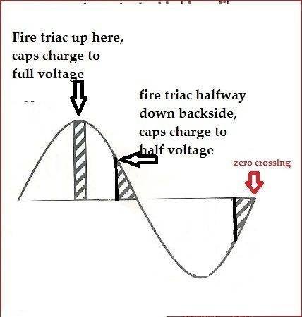

  • #69
Just want to share an insight (from the white paper) about why this is a "magnetic" power supply, and can have a significantly smaller transformer and output caps compared to conventional supplies.
(also, it is a class G amplifier, which vastly reduces output stage dissipation)
When the triac switches off, it opens the primary (like an ignition coil) and causes most of the transformers magnetic field energy to dump into the output capacitors.

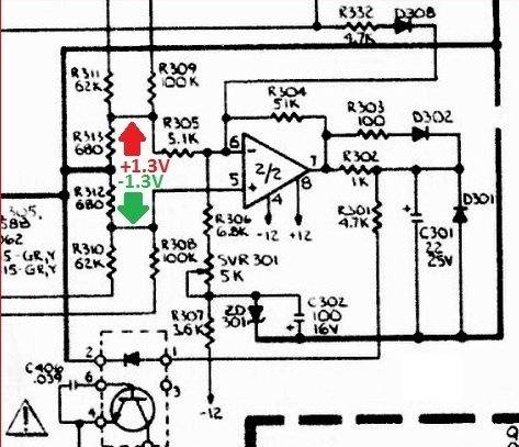

meBigGuy is thinking straight.
I too would like to see 'scope traces at top of R403-C405 to see of the cap is getting charged
and gate of triac to see if any of the charge on C405 makes it on over to gate

  • #74
well correct me if I'm wrong but I guess I'm starting to get there myself , the whole " secret" is in how and when you turn on or off the sine wave.
if I'm correct the magnetic field strength is larger when the rise or fall of a waveform is steeper or closer to vertical and also when the point at either turn on or off is at a higher potential , in other words if you switch the sine wave to the transformer primary while it's at about few volts above zero the field begins weak and then builds up with the sine wave but that happens evenly and quite slowly the same with turn off , but if you turn on the TRIAC when the sine wave is already at say near maximum , it has high potential at that point so the primary current starts quite quickly and the rise is fast so the field in the transformer starts much stronger than when it would begin together with the sine wave.
this is why they call it an " ignition coil" and ignition coil wo5rks much like an smps only the switching is the other way around , but in both cases you rapidly and suddenly apply a full steady DC potential to where no current and voltage was before and that gives you a rapid change in flux and if the energy source is strong enough a lot of power with it.
the sine wave starts much slower and ends the same way so it doesn't create the fast change in flux and at lower than peak voltages were the caps are already full it simply goes in and back away without much use except for winding loss and stray fields.
this is how I have came to see this if there is something wrong I would appreciate if someone corrected me , thanks.

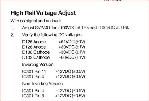

The fuse in the transformer is working because voltage got to the three main bridge rectifiers when I jumped the triac.
That fuse is for gate drive current, not power

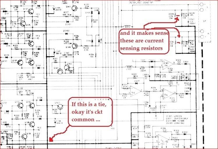

with it unplugged - got no ohms between p5 and p6 ?
on another track.......
The PCB track where D402's anode lands - any components nearby where a previous troubleshooter might have accidentally shorted something?
Seems to me this area would require caution when poking around.. check for smoke residue

To answer your question about D402 and the area near it...no sign of any shorts. I replaced all the resistors, the two diodes, and the four transistors connected to D402. I have tested the bridge rectifier and the optocoupler which I think are OK.
Cheers,
Billy
Update: after replacing the filter cap I smoked and disconnecting the 100V secondary the triac is working and sending current to the transformer. That is the good news.
Now I need to find the fault in the 100V part of the amp and when I do I think everything will go back to normal. This amp is a PITB to work on...lol...Don't try this at home...lol

Here's steady state flux and voltage.
if you energize a transformer by closing the switch(or Triac) at the voltage peak , you start with flux at zero and voltage at peak, which is normal and it's a gentle start for the transformer. That's why they sell solid state relays that switch at peak instead of zero crossing for use with inductive loads.
If you energize a transformer at the voltage zero crossing, you stare art with flux and voltage both at zero which is not normal and some period of adjustment will be required for the flux-voltage relation to establish normalcy.
from http://www.allaboutcircuits.com/textbook/alternating-current/chpt-9/practical-considerations-transformers/
since the transformer core will probably saturate there'll be a current inrush
That inrush can persist for several cycles
from a decent article here http://www.globalspec.com/reference/74817/203279/10-3-transformer-protection
you need to think derivative. For that it's helpful to use non-sine wave.
so closing the triac near peak is easier on the transformer's iron.
But it gives a current surge into the filter capacitors.
You might peruse that ideal transformer thread.
