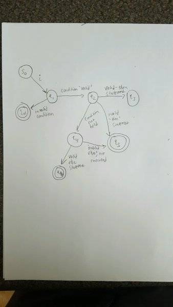

I was given the following question to answer for my Automata class:
function =

1. please design an automata to simulate the compiler.
2. how to write a compiler program for if-then-else statement
What exactly does it mean when it says "write a compiler program for the if-then-else statement?" I designed an automata/state machine simulating the basic if then else format for part 1, but is it asking for an arbitrary if then else programming example of my own choosing( like any kind of if statement example) or a code simulation of the automata I created for part 1? Forgive me if my question seems very basic, I'm very new to Automata theory

ChakanaX said:
The class has been really unclear and nobody really knows what she wants in this assignment, but this was assigned right after we went over context free grammar, we reviewed the basics of Formalism, Derivations, Backup-Naur FORM, and Left-most and right-most derivations. And i assume that's as far as she wanted to go for this particular homework assignment. But it's still confusing since I have this due before i have the chance to go to the TA and ask what we are suppose to do. The professor is really hard to understand. I have attached my attempt at part 1
