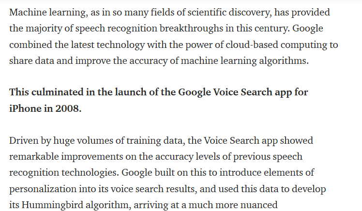

But now, Voice Recognition software has advanced to the point where multiple speakers can speak at normal speed and devices like cellphones and Alexa and Siri can usually get the interpretation correct. What has led to this huge step? I remember studying Voice Recognition algorithyms back in the early Dragon days, and marvelling at how complex things like phoneme recognition were. Were the big advances due mostly to increased computing power? Or some other adaptive learning techniques?
This article seems to address part of my question, but I'm still not understanding the fundamental leap that got us from Dragon to Alexa... Thanks for your insights.

I used to be an enthusiastic user of Google Voice Search (they called it google 411). It was the perfect machine learning platform because people with many accents in many backgrounds would ask similar questions. Then, it would get immediate feedback from the users if the recognition was correct or not. If the user replied "yes connect the call", it was successful. If not, then the user would retry.
From that, I assumed that it was just a neural net they were training. Or perhaps multiple cooperating nets. One working on words, and the other on semantics. "Please give me the number for pizza in Conway South Carolina." The question has a predictable structure. It can be expected to have object words "pizza", location words "conway", and noise words, "please give me". So the word guesses could be reinforced by the semantic structure.
But after several years, they abruptly discontinued the service. A press statement said that they had enough data.
"Breakthroughs" in machine learning are usually of the nature that they learn faster. But if you have enough data, enough money, enough time, even pre-breakthrough learning projects can succeed.
